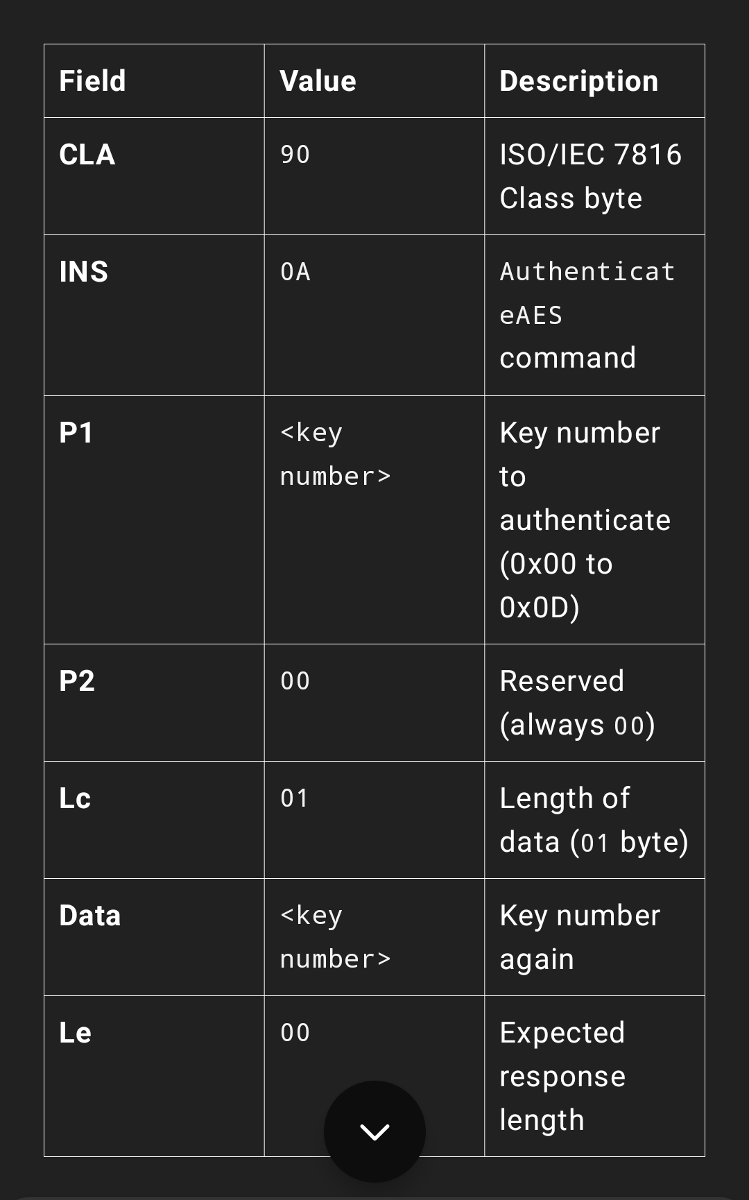

I’m wondering about the LC field. (length of data). Why is it 0x01? Is it the length of the key? I tried changing it to 0x08.
Is there a way I can view the APDU that is sent when I authenticate via the Proxmark? I have 2 Proxmarks. I tried the sniff command, but couldn’t understand what I was looking at in the .pm3 file it generated.
I don’t know much about DESFire, but your APDU seems to be borked. The response code 917E indeed means that your input APDU has an invalid command length. Your APDU 0x90, 0x0A, 0x00, 0x00, 0x01, 0x00, 0x00, 0x00, 0x00, 0x00, 0x00, 0x00, 0x00, 0x00 decodes to (also see Smart card application protocol data unit - Wikipedia):
  • CLA: 0x90 - proprietary, no secure messaging
  • INS: 0x0A - specific to the protocol you are using - DESFire
  • P1, P2: 0x00, 0x00 - Instruction parameters
  • LC: 0x01 - 1 byte of command data expected
  • [ 0x00 ] - The one byte of command data you specified
  • LE: 0x00 - Number of response bytes expected, 0 usually means to receive all available bytes
  • [ 0x00, 0x00, 0x00, 0x00, 0x00, 0x00, 0x00 ] - Another 7 bytes of unexpected additional data. This throws off the APDU parser of the card.
So, your APDU should look more like this: 0x90, 0x0A, 0x00, 0x00, 0x01, 0x00, 0x00 .
Yup, you are correct. I figured it out last night with the help of the RawNFC app. (I like it!)
Like Amal posted above, there is a challenge and response that I didn’t know about. Right now I’m trying to troubleshoot my reader on Ubuntu 24.04. I’m getting status 90 00 which is successful, but I’m not getting the actual challenge response outputted into my terminal.
