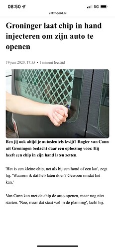

What i want is to unlock my car en even start it if is that’s possible
Research, not much because i am new here (in bio hacking)
Just so we are on the same page
Its possible, but unless it’s a Tesla… not much else has the right technology in the car to begin with
You can’t mimic a keyless fob or anything like that with an implant
You’ll have to add/remove/rewire stuff to get your car to unlock or start with an implant

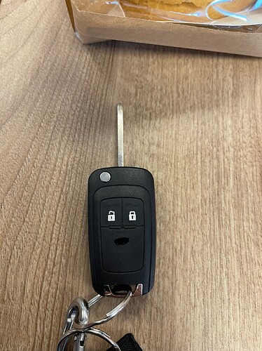

How does your car unlock? Proximity? Key fob? if it is a fob, how many buttons does it have? lock/unlock or a seperate lock and unlock?
Sorry for my late response
My car key has 2 buttons lock and unlock thats al
How to instal is either not the problem but i cant find what i need so thats wat i wanna know
