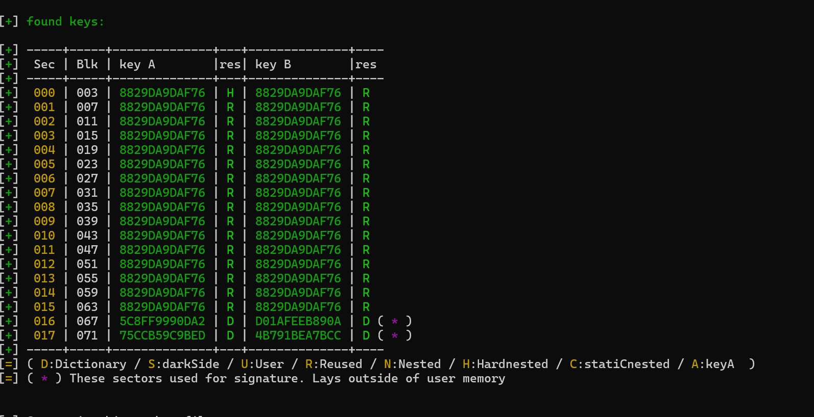

orig –
Sec | Blk | key A |res| key B |res
[+] 000 | 003 | 8829DA9DAF76 | H | 8829DA9DAF76 | R
[+] 001 | 007 | 8829DA9DAF76 | R | 8829DA9DAF76 | R
[+] 002 | 011 | 8829DA9DAF76 | R | 8829DA9DAF76 | R
[+] 003 | 015 | 8829DA9DAF76 | R | 8829DA9DAF76 | R
[+] 004 | 019 | 8829DA9DAF76 | R | 8829DA9DAF76 | R
[+] 005 | 023 | 8829DA9DAF76 | R | 8829DA9DAF76 | R
[+] 006 | 027 | 8829DA9DAF76 | R | 8829DA9DAF76 | R
[+] 007 | 031 | 8829DA9DAF76 | R | 8829DA9DAF76 | R
[+] 008 | 035 | 8829DA9DAF76 | R | 8829DA9DAF76 | R
[+] 009 | 039 | 8829DA9DAF76 | R | 8829DA9DAF76 | R
[+] 010 | 043 | 8829DA9DAF76 | R | 8829DA9DAF76 | R
[+] 011 | 047 | 8829DA9DAF76 | R | 8829DA9DAF76 | R
[+] 012 | 051 | 8829DA9DAF76 | R | 8829DA9DAF76 | R
[+] 013 | 055 | 8829DA9DAF76 | R | 8829DA9DAF76 | R
[+] 014 | 059 | 8829DA9DAF76 | R | 8829DA9DAF76 | R
[+] 015 | 063 | 8829DA9DAF76 | R | 8829DA9DAF76 | R
[+] 016 | 067 | 5C8FF9990DA2 | D | D01AFEEB890A | D ( * )
[+] 017 | 071 | 75CCB59C9BED | D | 4B791BEA7BCC | D ( * )

ok heres a screenshot of original card, showing the sectors 16 and 17, that don’t appear on the new card. The dump files I’ve been using don’t seem to carry the signature sectors… how do I include these to the new card ?
I have sifted for hours now looking through videos and tutorials and cannot find any information at all on these signature sectors… hopefully someone here can help. Let me know if this is something unknown too, so I know that you guys don’t know and I’ll stop asking ! haha
You can pretty safely ignore those extra blocks, their only purpose is holding the tag signature, and while I’m sure they exist, I don’t recall ever hearing of a system which actually uses the signature…
If that does end up being the case, then I think a Gen4 can do signature spoofing?

[=] | 2 | 00 00 00 00 00 00 00 00 00 00 00 00 00 00 00 00 | …
[=] | 3 | 88 29 DA 9D AF 76 7F 07 88 00 88 29 DA 9D AF 76 | .)…v…)…v
[=] 1 | 4 | 00 00 00 00 00 00 00 00 00 00 00 00 00 00 00 00 | …
[=] | 5 | 00 00 00 00 00 00 00 00 00 00 00 00 00 00 00 00 | …
[=] | 6 | 00 00 00 00 00 00 00 00 00 00 00 00 00 00 00 00 | …
[=] | 7 | 88 29 DA 9D AF 76 7F 07 88 00 88 29 DA 9D AF 76 | .)…v…)…v
[=] 2 | 8 | 00 00 00 00 00 00 00 00 00 00 00 00 00 00 00 00 | …
[=] | 9 | 00 00 00 00 00 00 00 00 00 00 00 00 00 00 00 00 | …
[=] | 10 | 00 00 00 00 00 00 00 00 00 00 00 00 00 00 00 00 | …
[=] | 11 | 88 29 DA 9D AF 76 7F 07 88 00 88 29 DA 9D AF 76 | .)…v…)…v
[=] 3 | 12 | 00 00 00 00 00 00 00 00 00 00 00 00 00 00 00 00 | …
[=] | 13 | 00 00 00 00 00 00 00 00 00 00 00 00 00 00 00 00 | …
[=] | 14 | 00 00 00 00 00 00 00 00 00 00 00 00 00 00 00 00 | …
[=] | 15 | 88 29 DA 9D AF 76 7F 07 88 00 88 29 DA 9D AF 76 | .)…v…)…v
[=] 4 | 16 | 00 00 00 00 00 00 00 00 00 00 00 00 00 00 00 00 | …
[=] | 17 | 00 00 00 00 00 00 00 00 00 00 00 00 00 00 00 00 | …
[=] | 18 | 00 00 00 00 00 00 00 00 00 00 00 00 00 00 00 00 | …
[=] | 19 | 88 29 DA 9D AF 76 7F 07 88 00 88 29 DA 9D AF 76 | .)…v…)…v
[=] 5 | 20 | 00 00 00 00 00 00 00 00 00 00 00 00 00 00 00 00 | …
[=] | 21 | 00 00 00 00 00 00 00 00 00 00 00 00 00 00 00 00 | …
[=] | 22 | 00 00 00 00 00 00 00 00 00 00 00 00 00 00 00 00 | …
[=] | 23 | 88 29 DA 9D AF 76 7F 07 88 00 88 29 DA 9D AF 76 | .)…v…)…v
[=] 6 | 24 | 00 00 00 00 00 00 00 00 00 00 00 00 00 00 00 00 | …
[=] | 25 | 00 00 00 00 00 00 00 00 00 00 00 00 00 00 00 00 | …
[=] | 26 | 00 00 00 00 00 00 00 00 00 00 00 00 00 00 00 00 | …
[=] | 27 | 88 29 DA 9D AF 76 7F 07 88 00 88 29 DA 9D AF 76 | .)…v…)…v
[=] 7 | 28 | 00 00 00 00 00 00 00 00 00 00 00 00 00 00 00 00 | …
[=] | 29 | 00 00 00 00 00 00 00 00 00 00 00 00 00 00 00 00 | …
[=] | 30 | 00 00 00 00 00 00 00 00 00 00 00 00 00 00 00 00 | …
[=] | 31 | 88 29 DA 9D AF 76 7F 07 88 00 88 29 DA 9D AF 76 | .)…v…)…v
[=] 8 | 32 | 00 00 00 00 00 00 00 00 00 00 00 00 00 00 00 00 | …
[=] | 33 | 00 00 00 00 00 00 00 00 00 00 00 00 00 00 00 00 | …
[=] | 34 | 00 00 00 00 00 00 00 00 00 00 00 00 00 00 00 00 | …
[=] | 35 | 88 29 DA 9D AF 76 7F 07 88 00 88 29 DA 9D AF 76 | .)…v…)…v
[=] 9 | 36 | 00 00 00 00 00 00 00 00 00 00 00 00 00 00 00 00 | …
[=] | 37 | 00 00 00 00 00 00 00 00 00 00 00 00 00 00 00 00 | …
[=] | 38 | 00 00 00 00 00 00 00 00 00 00 00 00 00 00 00 00 | …
[=] | 39 | 88 29 DA 9D AF 76 7F 07 88 00 88 29 DA 9D AF 76 | .)…v…)…v
[=] 10 | 40 | 00 00 00 00 00 00 00 00 00 00 00 00 00 00 00 00 | …
[=] | 41 | 00 00 00 00 00 00 00 00 00 00 00 00 00 00 00 00 | …
[=] | 42 | 00 00 00 00 00 00 00 00 00 00 00 00 00 00 00 00 | …
[=] | 43 | 88 29 DA 9D AF 76 7F 07 88 00 88 29 DA 9D AF 76 | .)…v…)…v
[=] 11 | 44 | 00 00 00 00 00 00 00 00 00 00 00 00 00 00 00 00 | …
[=] | 45 | 00 00 00 00 00 00 00 00 00 00 00 00 00 00 00 00 | …
[=] | 46 | 00 00 00 00 00 00 00 00 00 00 00 00 00 00 00 00 | …
[=] | 47 | 88 29 DA 9D AF 76 7F 07 88 00 88 29 DA 9D AF 76 | .)…v…)…v
[=] 12 | 48 | 00 00 00 00 00 00 00 00 00 00 00 00 00 00 00 00 | …
[=] | 49 | 00 00 00 00 00 00 00 00 00 00 00 00 00 00 00 00 | …
[=] | 50 | 00 00 00 00 00 00 00 00 00 00 00 00 00 00 00 00 | …
[=] | 51 | 88 29 DA 9D AF 76 7F 07 88 00 88 29 DA 9D AF 76 | .)…v…)…v
[=] 13 | 52 | 00 00 00 00 00 00 00 00 00 00 00 00 00 00 00 00 | …
[=] | 53 | 00 00 00 00 00 00 00 00 00 00 00 00 00 00 00 00 | …
[=] | 54 | 00 00 00 00 00 00 00 00 00 00 00 00 00 00 00 00 | …
[=] | 55 | 88 29 DA 9D AF 76 7F 07 88 00 88 29 DA 9D AF 76 | .)…v…)…v
[=] 14 | 56 | 00 00 00 00 00 00 00 00 00 00 00 00 00 00 00 00 | …
[=] | 57 | 00 00 00 00 00 00 00 00 00 00 00 00 00 00 00 00 | …
[=] | 58 | 00 00 00 00 00 00 00 00 00 00 00 00 00 00 00 00 | …
[=] | 59 | 88 29 DA 9D AF 76 7F 07 88 00 88 29 DA 9D AF 76 | .)…v…)…v
[=] 15 | 60 | 00 00 00 00 00 00 00 00 00 00 00 00 00 00 00 00 | …
[=] | 61 | 00 00 00 00 00 00 00 00 00 00 00 00 00 00 00 00 | …
[=] | 62 | 00 00 00 00 00 00 00 00 00 00 00 00 00 00 00 00 | …
[=] | 63 | 88 29 DA 9D AF 76 7F 07 88 00 88 29 DA 9D AF 76 | .)…v…)…v
[=] 16 | 64 | 00 00 00 00 00 00 00 00 00 00 00 00 00 00 00 00 | …
[=] | 65 | 00 00 00 00 00 00 00 00 00 00 00 00 00 00 00 00 | …
[=] | 66 | 00 00 00 00 00 00 00 00 00 00 00 00 00 00 00 00 | …
[=] | 67 | 5C 8F F9 99 0D A2 70 F0 F8 69 D0 1A FE EB 89 0A | .…p…i…
[=] 17 | 68 | 48 4B 54 31 30 35 0B 06 16 7F 70 00 00 00 00 00 | HKT105…p…
[=] | 69 | F2 45 9D 33 3C 41 09 F2 09 4B 2D A9 FC CF 3A CE | .E.3<A…K-…:.
[=] | 70 | 54 08 58 A2 7C E5 42 9D C9 E9 93 76 94 CA CD FC | T.X.|.B…v…
[=] | 71 | 75 CC B5 9C 9B ED 70 F0 F8 69 4B 79 1B EA 7B CC | u…p…iKy…{.
