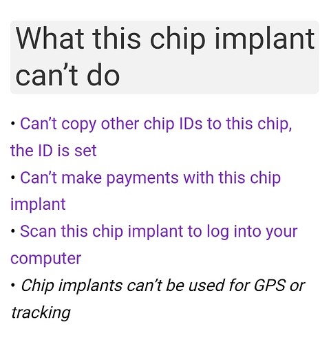

Does it have to be magic? Like could I write it onto this chip supporting the ISO15693?
Yes it needs to be magic. Taken from the product page:
That said the purpose of that implant is if you can get the system administrator to agree to enrolling it they can enrol it like they do any other tag.
