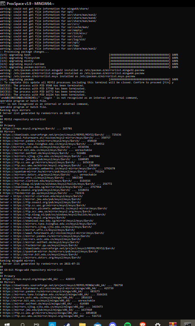

When you do this, watch the output for errors and rather than show us the end of the output with the errors it would be great if you could show us the beginning.
Something went wrong earlier than we can see on that last output, and without seeing the first errors we can’t even guess at what the issue is.

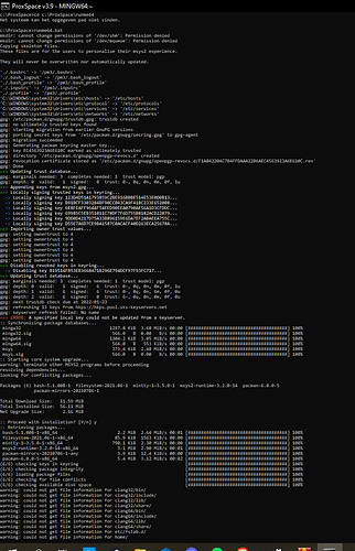

I tried @amal 's Method and this is prettymuch everything it did:

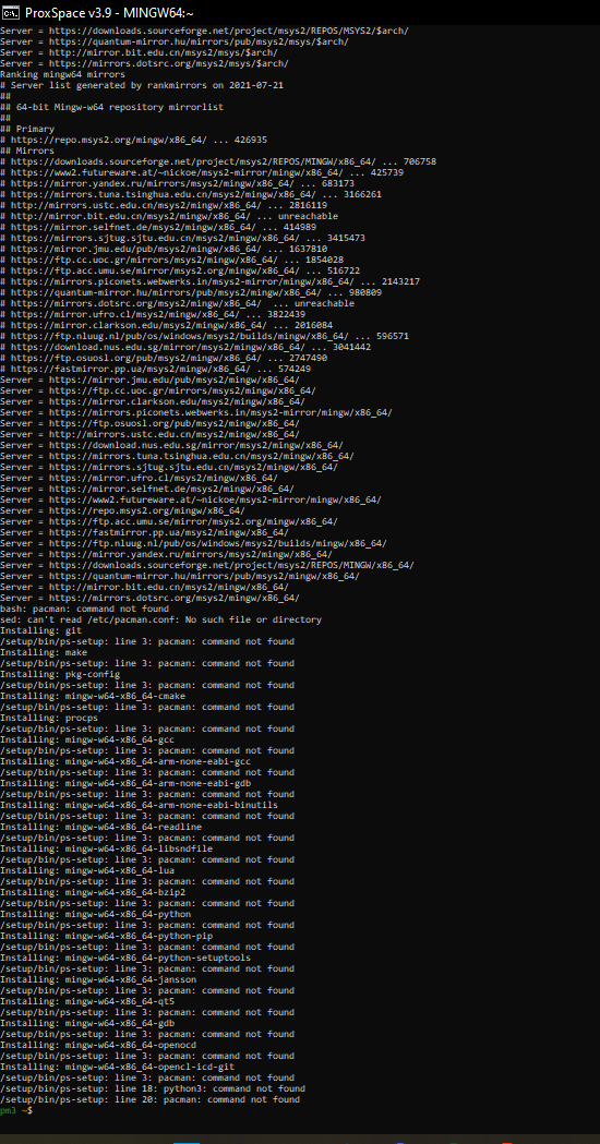

A lot of things not being found.
Yes, but just before that it fails to write to /etc/pacman.conf. this is the configuration file for pacman. I suspect a permissions issue as there are various warnings attempting to look at files at the top. Then bash attempts to run pacman after it has allegedly been installed and can’t find the command.
Are you sure that you were doing this as administrator?

This is what i’m getting now when i run it as administrator
