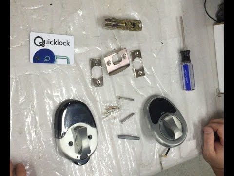

So I was wrong to assume that the door unlock is done by using the RFID ID right?, I read an article that said you can make a door lock Arduino that scans the ID or serial of the chip and if it matches something it will open without needing data written to the device? Is this true or will this not work in this scenario?
Door locks can use either RFID or NFC, but most workplaces use RFID as it uses LF technology, so it’s cheaper to implement and I’m general has longer read range. It all depends on what you’re trying to authenticate to - your house workplace, etc.
The Arduino scenario could work but it would take some tech know-how. There are tutorials online for it.

You can unlock HF access control systems that are looking for the UID using the Spark
An Arduino connected to an R522 or PN532 module would read the UID just like a normal tag. Some off-the-shelf door locks will work, but others might not play nice with the Spark. Here is a list of compatible products
