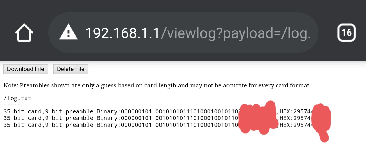

I used an ESP-KEY and an RP40 multiclass reader to extract the raw Wiegand data from my badge
I took the raw hex data from it and used
lf hid clone -r
on my proxmark to clone to a blank t55x7 fob I had handy. Once I confirmed its raw data was the same as my badge I repeated the command on my implant. In this picture you can see my official badge, test fob, and implant all showing the exact same raw data.
Long story short it is possible to clone a high frequency iClass DY credential to a low frequency t55xx chip but in my case the card data is so much longer now it is almost impossible to line up on a reader to get a solid read. I have already ordered a flexEM to use instead and will update if it works better.
