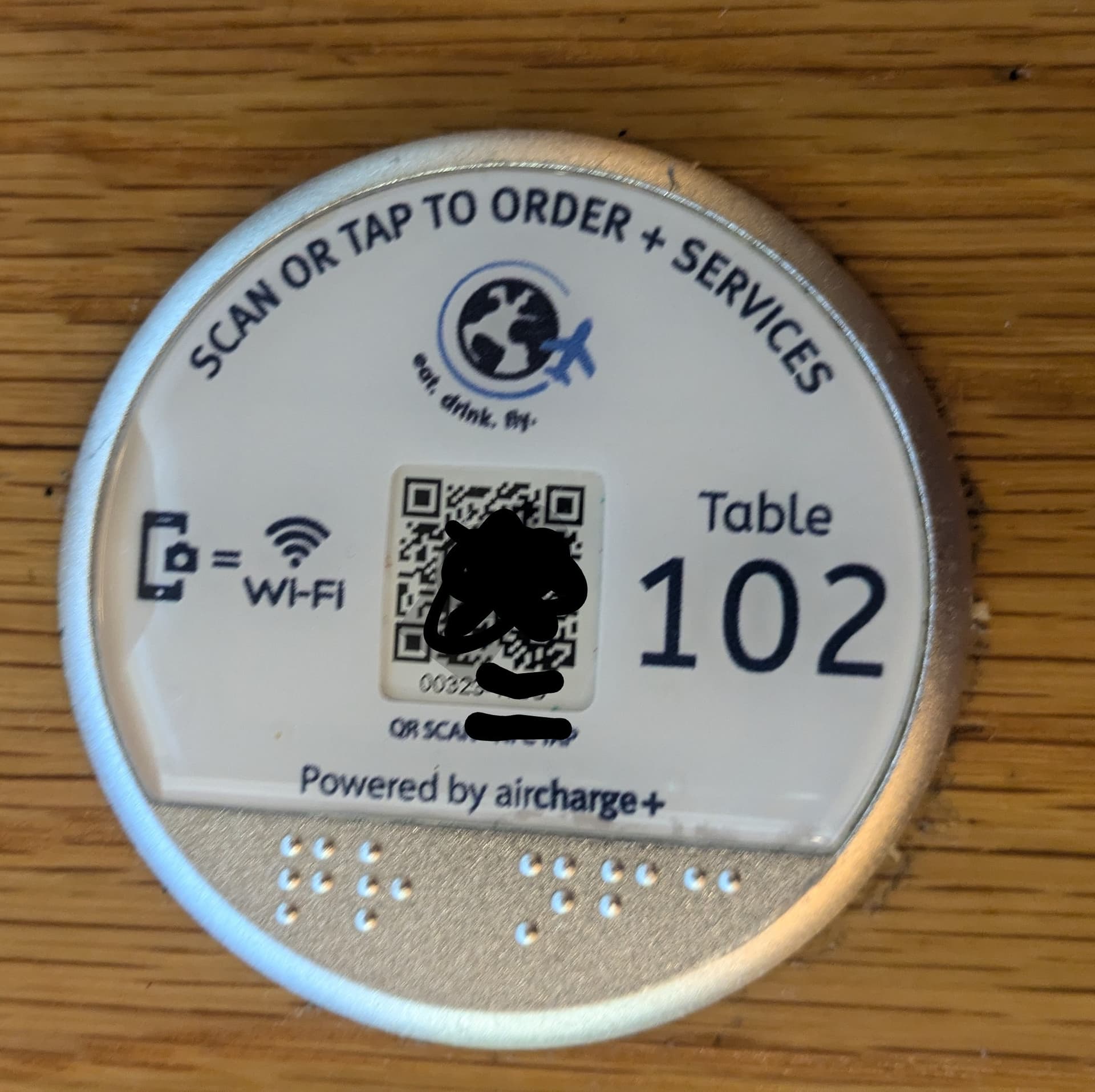

Came across one of these in the wild.

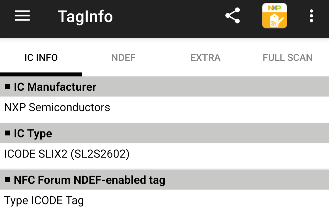

Not familiar with them I pulled the datasheet and found out they have a pretty large memory and some cool functions:
  • 2560-bit user accessible EEPROM
  • several types of password protection, read/write protection …
  • comes in several form factor including moa8
SL2S2602.pdf (544.4 KB)
Thinking it might be an alternative to the ntag, but with more functions and memories?
What y’all think?
X

It seam to pop up link automatically, which is neat. I was surprised by the storage size. They are surprisingly cheap so I may “have” to pick a few to play with :sweat_smile:
We’re behind in the US :roll_eyes:
Found it at a restaurant, but they didn’t have the back end up and running yet …
Ho … and it’s the 2.1mm glassie too …
