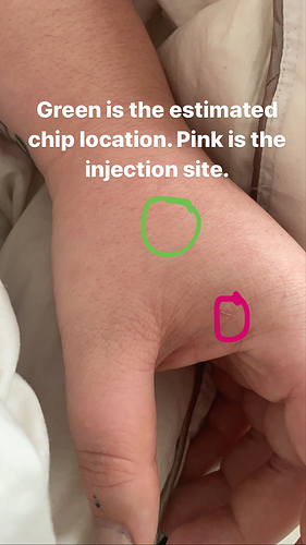

Had an implant installed in my hand by a nurse. It’s had Weeks to heal and won’t read. I believe it was installed too deep under the skin. Should I get it removed? Is there a way for me to salvage this?

          Can you also mark on the image (or your hand) where your bones are?
