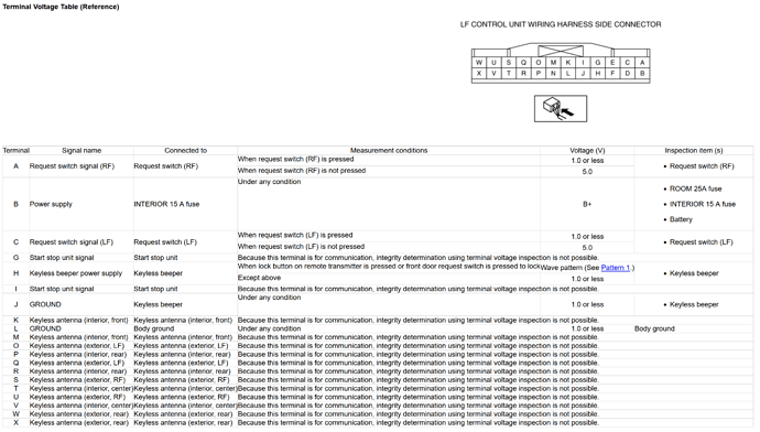

As an update, I found the exact module and a pinout that I need for the “Vehicle Anti-Button Entry System” or VABES if you like terrible acronyms :smile:. The xAC that came with my lifestyle kit should be ideal for this project. A small relay to trigger the doors will probably be appropriate to unlock or lock. Assuming my car key is on my person at the same time. Updates tomorrow if all goes according to plan.
For anyone else with a ND1 Mazda MX-5 this is the diagram I’m looking at. The module is behind the right front side trim in the passenger footwell.
