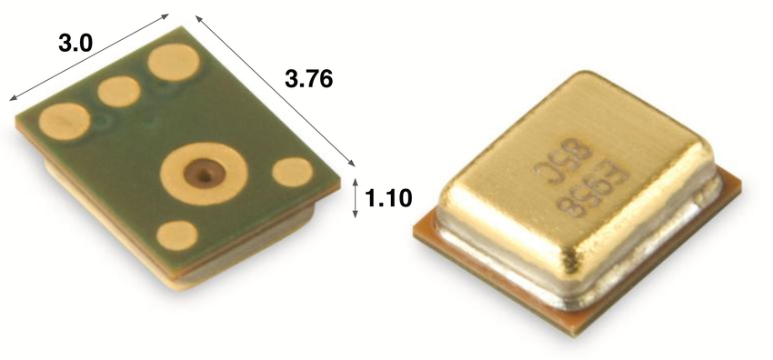

Ever thought of replacing a tooth?
I mean that one’s easy. Just use a MEMS microphone.
