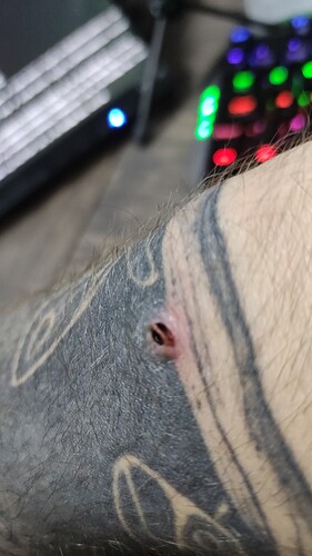

So…
  • I Implanted the magnet in my wrist, outside of it.
  • Then I’m handling some sensitive equipment, which includes a very powerful magnet mounted in some brackets.
  • Brackets break from wear and tear and large magnet falls. Gravity did most of the work there, but the titan surely helped steer the magnet straight into my wrist!
On any other day it would just hit my soft bits, the impact would get distributed through the jiggly flesh, and we would just curse a tiny bit.
Yet… instead of hitting soft flesh, the magnet encountered a tiny lump of titanium coming against it in equal force… leaving only a thin layer of skin in between, which obviously broke. (as in breaking skin. aka cut and bleed).
The implanted magnet was still implanted by then (YAY!), but got dragged closer to the surface, leaving a larger and stretched out pocket… and the skin rupture wasn’t recovering so well…
So I decided to remove the Titan.
I thought of removing it properly, with plastic tweezers to hold it in place while I would cut the pocket open with a scalpel…
But before that, why not have some fun testing how the Titan flips around on itself near a large magnet…
And justlike that I ended up yanking the Titan out of myself…
Gory image
Wasn’t subtle. I definitely let my morbid curiosity get the best of me! :sweat_smile:
But I used nothing else but a large magnet. (and the broken skin from the previous accident, which hadn’t sealed yet by then)
