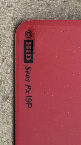

My work uses the (relatively) recent HID Seos cards and readers for their access control. I’ve looked through the datasheet, and as far as I can tell although the vivokey has cryptographic ability, seos is proprietary and therefore I’m not really sure if it will work as a replacement for my key card. The card I have wasn’t marked with exact branding, but from what I can tell it’s part of their 500x series, and therefore isn’t compatible with any existing legacy technologies. All the relevant branding I could see was the “HID Seos IP” on the bottom left of the card, and on the bottom right “xt”.
Can someone with more experience than me take a look and see if these are compatible, and if possible explain why/why not so I can be more informed?

It looks like SEOS is a java card applet… so no chance of cloning your card to an implant. There may be a future though where SEOS runs on the VivoKey Flex One… just would require cooperation from HID. This would be a Fidesmo question though.

So if my work place uses this same type of cards and readers, is there any implant that can act as one of this cards? Not to clone an existing one but as a completely new one?

What chip is in there? Maybe we convert it :slight_smile:
It’s um…not exactly my card. lol.
** TagInfo scan (version 4.25.4) 2023-08-11 13:46:00 **
Report Type:
-- IC INFO ------------------------------
# IC manufacturer:
Unknown manufacturer
# IC type:
Unknown IC implementing ISO/IEC 14443-4
-- NDEF ------------------------------
# No NDEF data storage populated:
-- EXTRA ------------------------------
# TagInfo Version:
Version :4.25.4
# Device Info:
Device Model :samsung ( SM-S908U1 )
Android OS Version :12
-- FULL SCAN ------------------------------
# Technologies supported:
ISO/IEC 7816-4 compatible
ISO/IEC 14443-4 (Type A) compatible
ISO/IEC 14443-3 (Type A) compatible
# Android technology information:
Tag description:
* TAG: Tech [android.nfc.tech.IsoDep, android.nfc.tech.NfcA]
* Maximum transceive length: 65279 bytes
* Default maximum transceive time-out: 618 ms
* Extended length APDUs supported
* Maximum transceive length: 253 bytes
# Detailed protocol information:
* Random ID
ATQA: 0x0100
SAK: 0x20
ATS: XXX
* Max. accepted frame size: 256 bytes (FSCI: 8)
* Supported receive rates:
	- 106, 212, 424, 848 kbit/s (DR: 1, 2, 4, 8)
* Supported send rates:
	- 106, 212, 424, 848 kbit/s (DS: 1, 2, 4, 8)
* Different send and receive rates supported
* SFGT: 302.0 us  (SFGI: 0)
* FWT: 77.33 ms  (FWI: 8)
* NAD not supported
* CID supported
* Historical bytes: [none]
I edited out the ID, but I see now it is indeed random.
