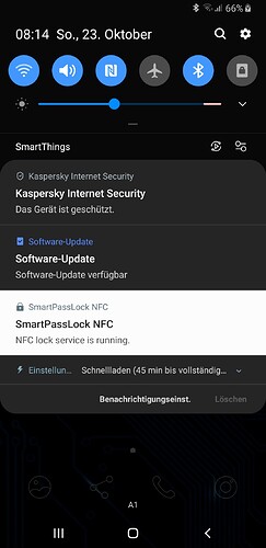

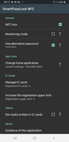

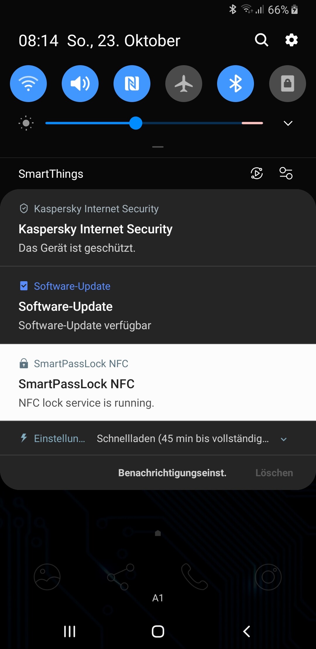

there is an App, but the App has bugs. It wirks only up to Android 9
important: Set alternative password.
Sometimes the app is offline, you must activate it again.
if this is activated, the app works
