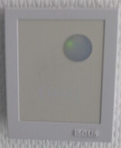

Could you post a picture of the reader?
We MIGHT be able to identify the system therefore the card type you are using.

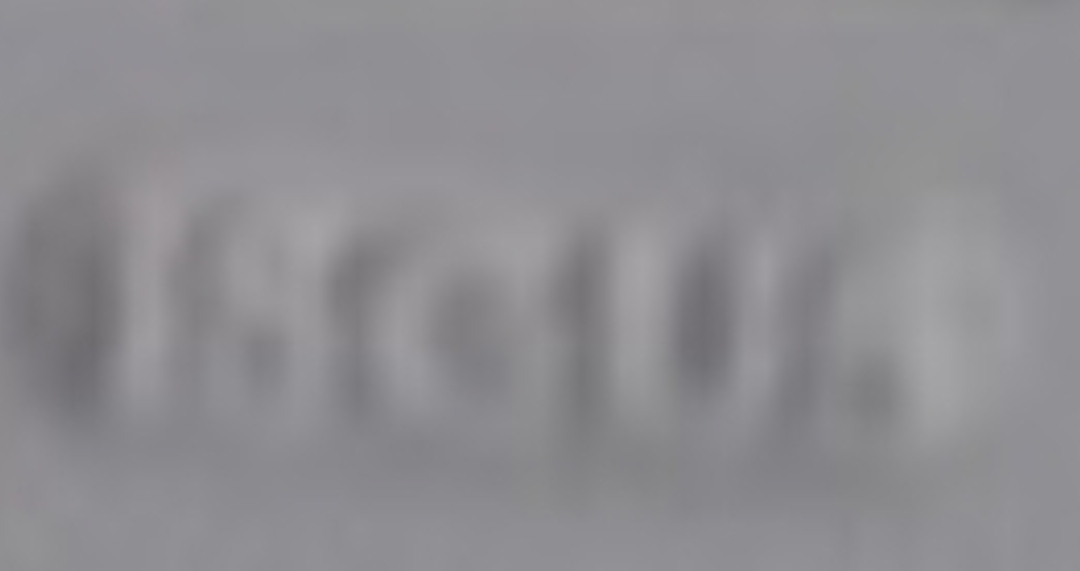

Any chance you can read this for me?
I have a couple of guesses but to save me some time…
or if you can’t, can you take another photo of a little more reader, a little less wall
I read “isgus” from the pictures but I failed to find that particular reader on their website? Maybe it’s an older model and I’d have to dig deeper?
Their current offerings support a variety of tags, as most modern readers do…
its isgus.
i think its an older 1 yeah bcuz i couldnt find it either.
It appears to be an older isgus it400 or it400sss based on the following listings
