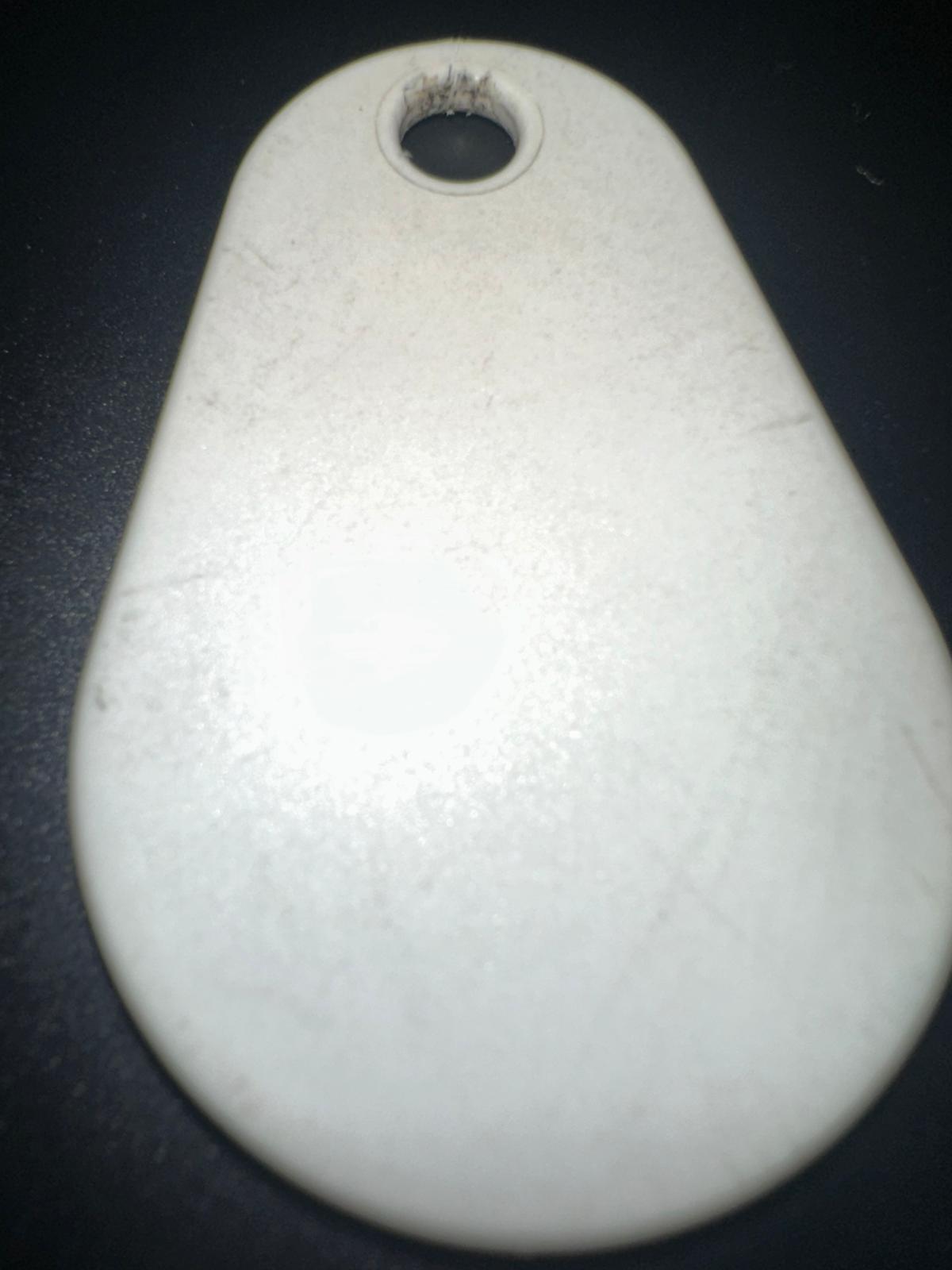

Can you post a picture of the tag? Or does it have any branding or identifying marks on it?

Tag shows no identifiers front and back.

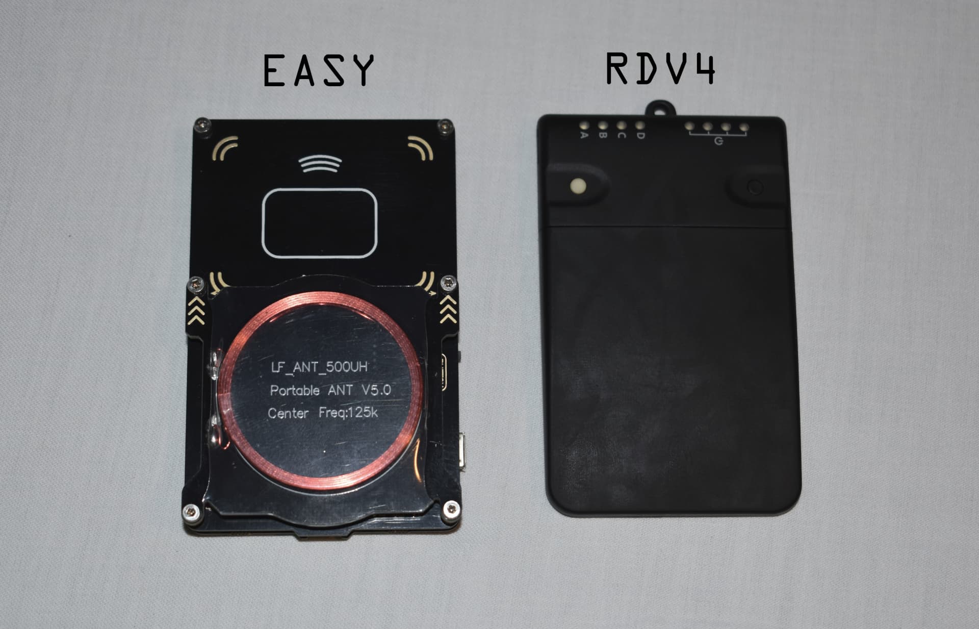

This is the important part. Are you using pre-compiled binaries or are you pulling down the source code from the repo and compiling it?
Do you have an RDV4? If not, you must modify your makefile to tell the compiler to compile the right firmware version for your hardware.
The above guide has a section on how to do this.
If you are using the precompiled binaries make sure you’re using the correct ones:
RDV4
Generic
Scratch that, those are for Windows, not Mac, my bad
If you don’t know which you have:
If it doesn’t look like the RDV4 you have a “generic”

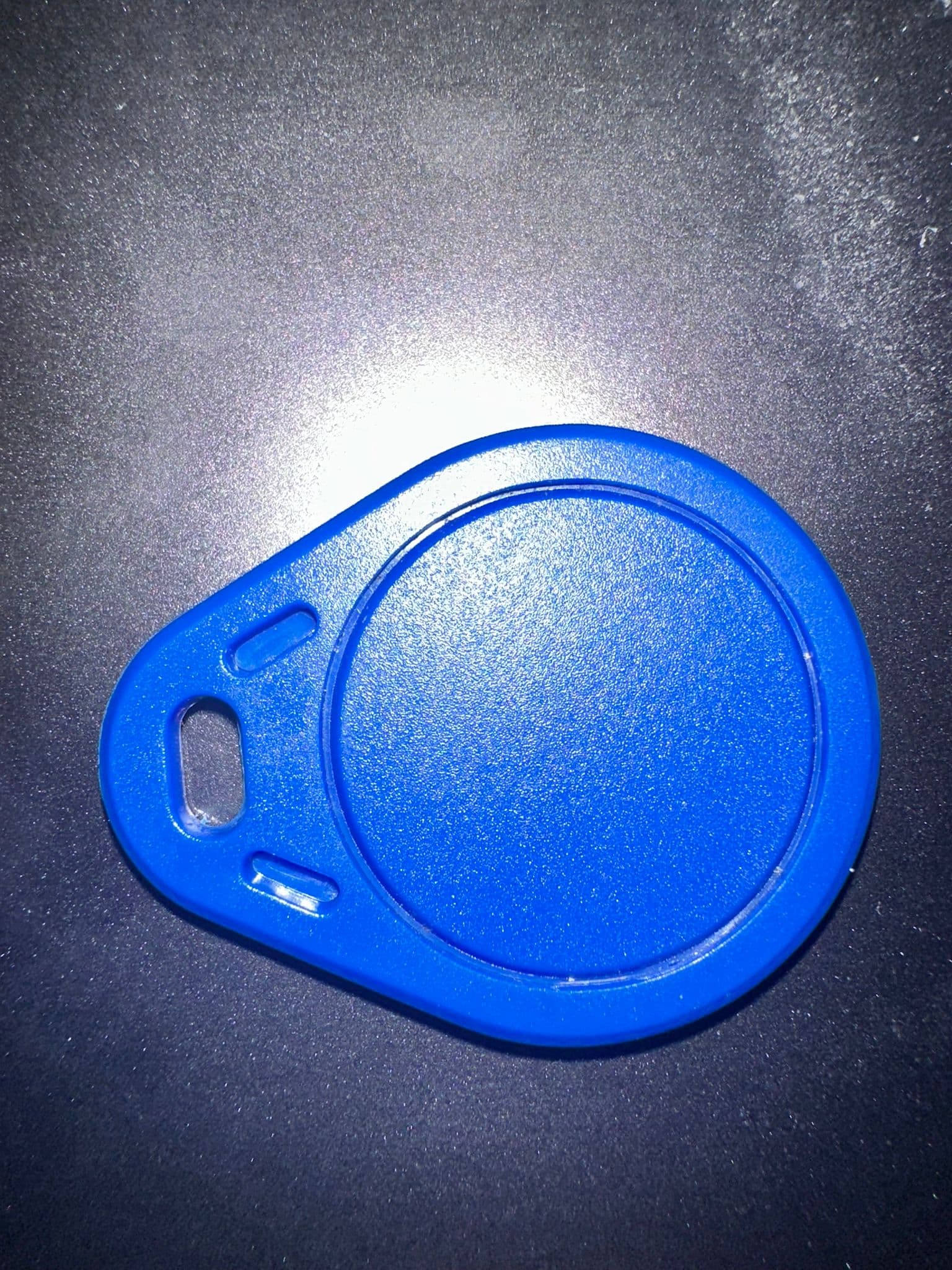

When I try the new blue fob at the door reader, there is no response at all. Should I try a different type of tag?

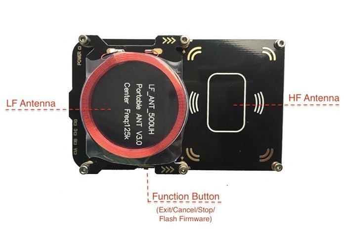

Since that fob looks kinda thin, I suspect that it’s a high frequency tag. However, this can be wrong.
The Proxmark3 Easy has 2 antennas, the coil for low frequency fobs, and the BCB trace antenna for high frequency ones.
I suggest placing the fob on the LF coil and running an lf search, then moving the fob to the HF side of the Proxmark3 Easy, and running a hf search command.
If that fails, the lf tune and hf tune commands should help you locate the best location for reading the tag. You want to leave it on the spot that gives you the lowest voltage reading.
Sensational, that did the trick. I tried putting the original between the lowest board and the HF board, got what I was suspecting originally:

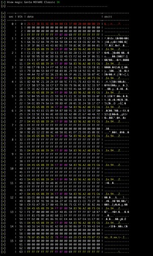

autopwn got me all of the decoded keys. No sectors with -------
And only two sectors with FFFFFFFFFFFF. Looks ready for cload
However, there is no eml file, just a json and bin file. I tried cload help but don’t see anything for eml. I tried loading the json but wasn’t expecting that to work. Two issues might be the eml and is the blue fob that came with the Easy package a Classic 1K but not a magic one?
[+] Generating binary key file
[+] Found keys have been dumped to `/Users/xyz/hf-mf-26C23BB1-key-001.bin`
[=] --[ FFFFFFFFFFFF ]-- has been inserted for unknown keys where res is 0
[=] Transferring keys to simulator memory ( ok )
[=] Dumping card content to emulator memory (Cmd Error: 04 can occur)
[=] downloading card content from emulator memory
[+] Saved 1152 bytes to binary file `/Users/xyz/hf-mf-26C23BB1-dump-001.bin`
[+] Saved to json file /Users/xyz/hf-mf-26C23BB1-dump-001.json
[=] Autopwn execution time: 104 seconds
[usb] pm3 --> hf mf cload -f /Users/xyz/hf-mf-26C23BB1-dump-001.json
[+] loaded `/Users/xyz/hf-mf-26C23BB1-dump-001.json`
[=] Copying to magic gen1a MIFARE Classic 1K
[=] .[#] wupC1 error
[!] ⚠️  Can't set magic card block: 0
[?] Hint: Verify that it is a GDM and not USCUID derivative

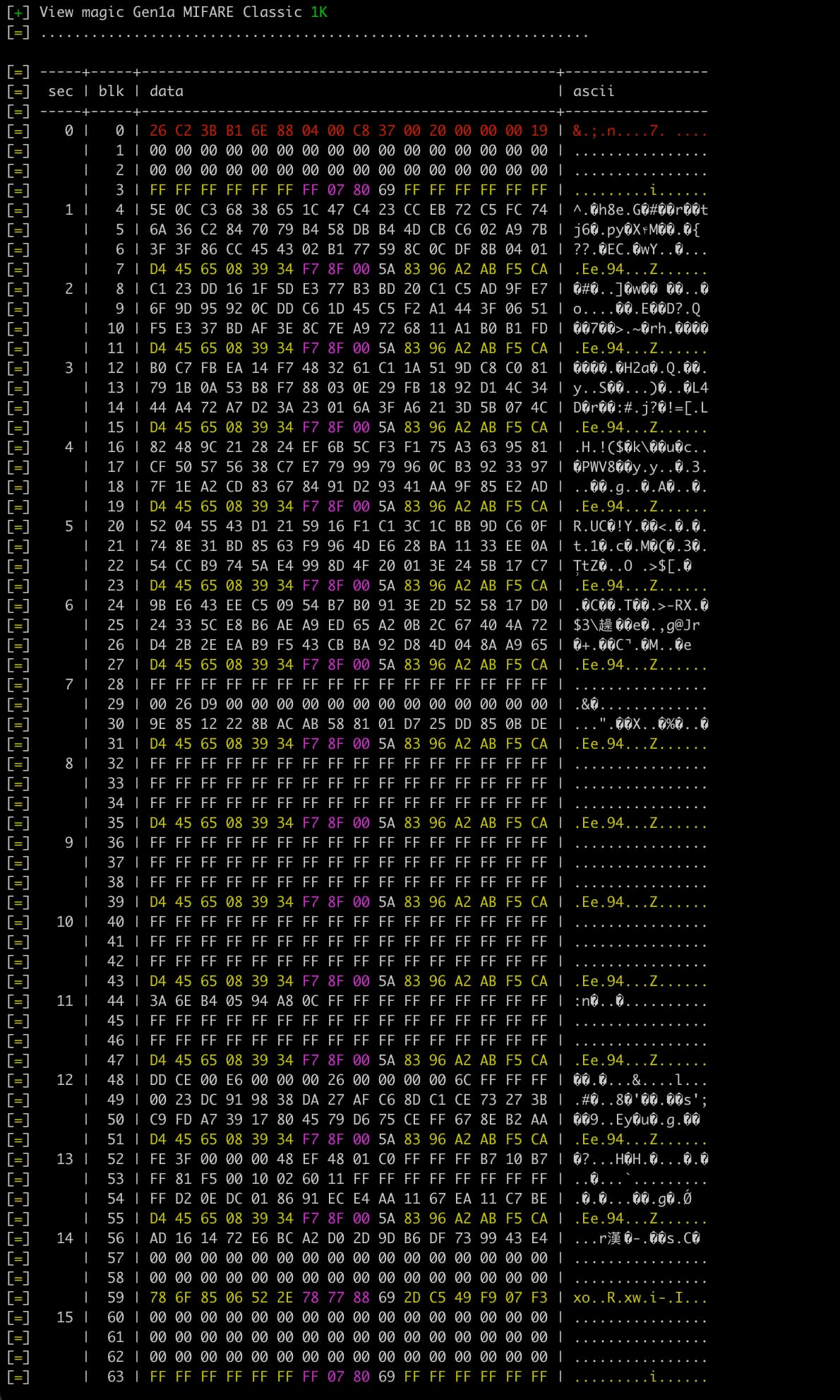

The eml file format has been removed, either of the other two formats will work in its place
Is definitely a problem for cloning :classic_tongue:
The json reports:
"FileType": "mfc v2",

Update. Cloning with the correct card has worked on the first reader I tested against. Works perfectly when tested on the reader.
The second reader, which I thought would be less secure but which uses the same original fob, did not show any response to the card. So, I am looking for hints in the 16 sectors for what I could still need to run, possibly a specific block write command?
Commands from the clone:

cview output from the clone:
Are you sure your original fob isn’t dual frequency and the second reader is just not HF or reacting to HF (might be putting field out but not doing anything with it)? Have you tested both readers with RDC?
It might have something to do with SAK Swapping:
Since it looks like you have a Gen4 GDM card, you should be able to tinker with the SAK, I believe
