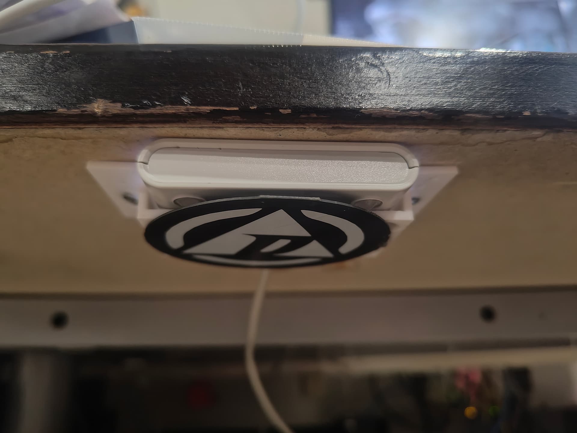

Underside mount with booster to get perfectly blind reads every time.

But those times are fairly infrequent and I wouldn’t pick an install location just to make the occasional applet install easier. You can install/remove applets with either a phone or the desktop command line utility. Android phones can install all applets. iPhones are more locked down and they can’t install “privileged” applets like FIDO2. Even on Android phones though, applet installation is finicky. You have to have good coupling between the chip and the reader, and maintain that coupling for seconds to tens of seconds. The repeater stickers help, but I still prefer installing applets via a desktop reader. Amal’s earlier suggesting of mounting a reader on the underside of a desk is a great idea. For me, I just prepare the CLI command, keep my hand flat, then put the USB reader on top and press enter. Works first try 90% of the time. Installing an applet requires a lot more bandwidth and data transfer then using an already installed applet for authentication.

That’s exactly what my desk looks like. Are you able to use acru for Windows login?

Yeah.. it’s actually an hid omniman 5022CL reader and I use rohos for login sadly
