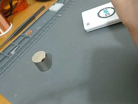

Thank you for the detailed answer!
Thank you so much for such a useful video
There’s some other good videos on that channel that explore random questions implantees have asked over the years.
