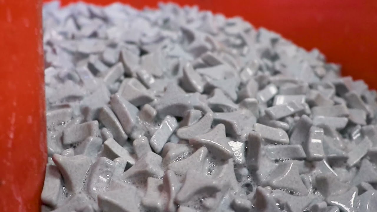

I’d also look into vibratory deburring it. It’ll give it a nice smoothed finish and remove any nasty sharp corners left over from machining.
Best video I could find:
