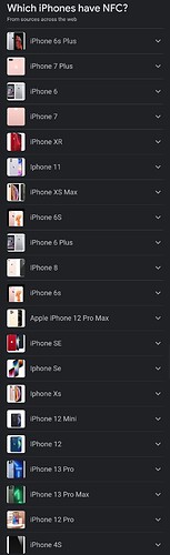

I did a quick google search and this was the first result i.e. (I cant confirm the accuracy)

:eyeroll: That list includes the iPhone 4S which hardly has a phone antenna, let alone NFC!
Yup. That’s what my question was. :slightly_smiling_face:
