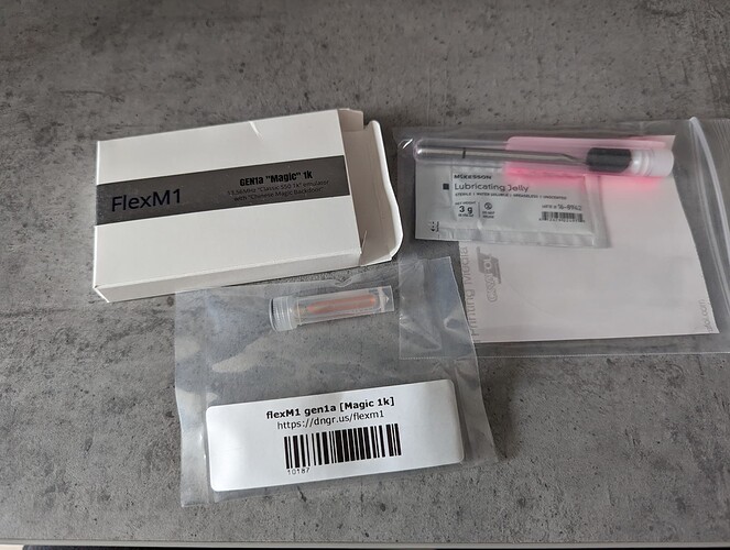

I ordered flexM1 gen1a from ksec.co.uk 3 months ago, and when I went to test it on my apartment building door it didn’t work (I guess the system is “smart” enough to recognize the magic card). I’d be happy to sell it to you if you don’t mind it being “second hand”. I never touched the sterilized pouch; I’ve only set the UID with Proxmark and then tried it several times “from inside the pouch”.

I’ve just discovered that the implant works just fine. Before I went to test it, I’ve yet again checked my key fob and the implant and compared all the values. But this time I noticed one little detail: SAK on the fob was 08, SAK on the implant was 88.
Yep, that’s it…I made a typo when I was setting the implant UID, and even though I at least quadruple-checked it, I think that I didn’t pay enough attention to SAK and was primarily checking the UID (or I’m just braindead, not sure). Anyway, today I saw the mistake immediately, double-checked again, set the correct values, and tested the implant…yep, the signal is not perfect, but…it works.

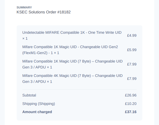

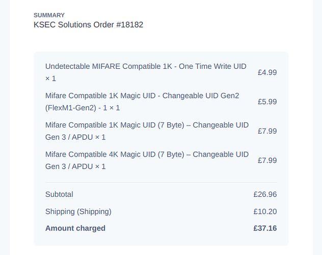

Price for dementia: 37.16 British pounds + three months time.
