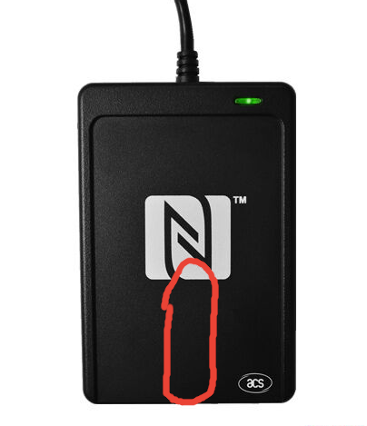

I have no knowledge about this “Hammy Field Detector”, but I bought one of these a few years ago: USB ACR122U Reader/Writer - RFID & NFC Chip Implants and Biohacking products

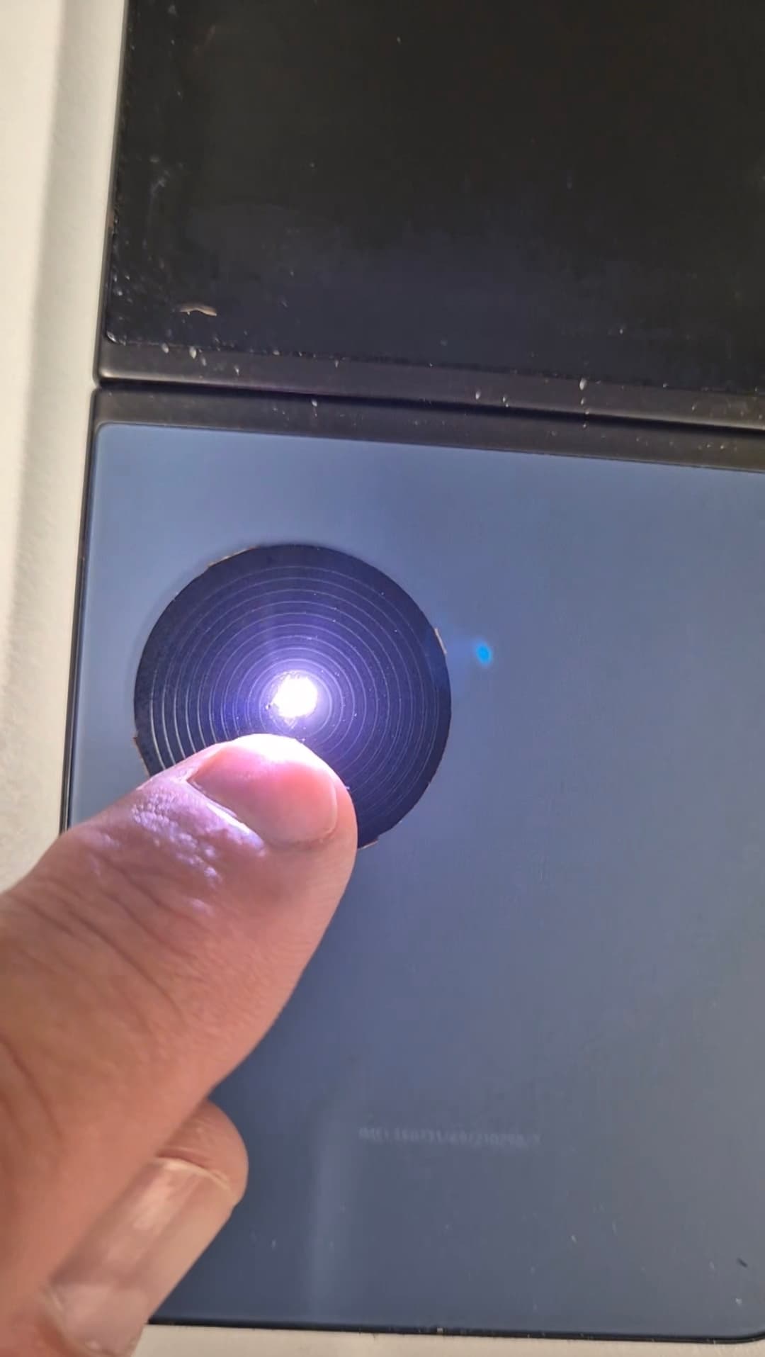

This is what i will use to visually find the best placement for the repeater sticker, where the LED is at its brightest is the spot the sticker goes.
This should also read it no problem

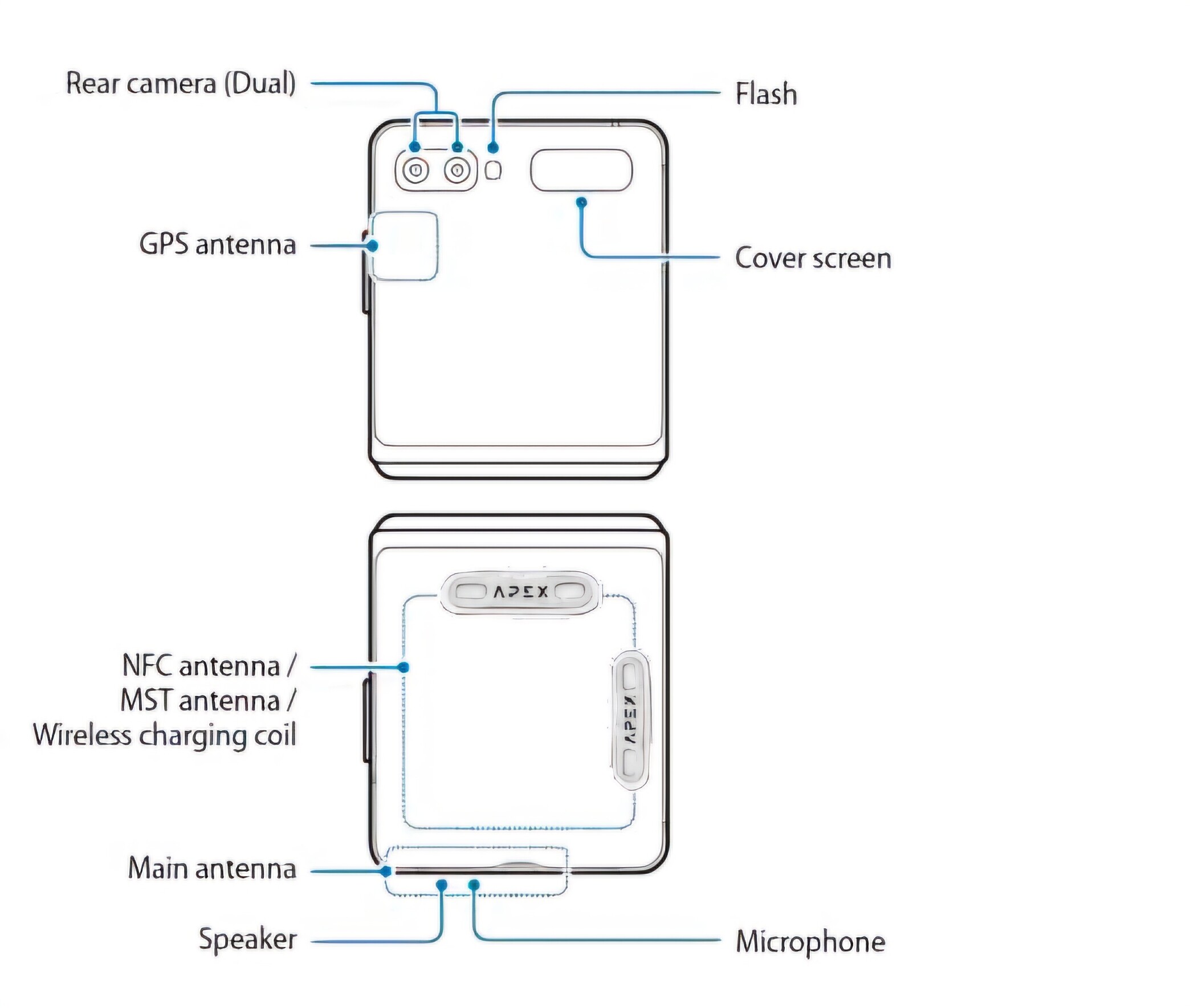

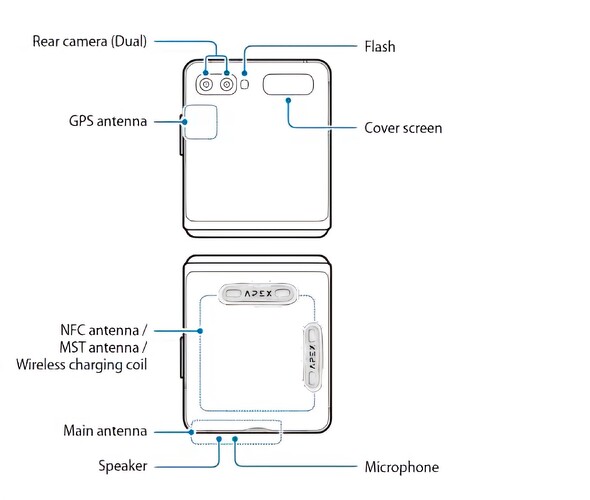

Image stolen from Amals post to give you an idea about placement

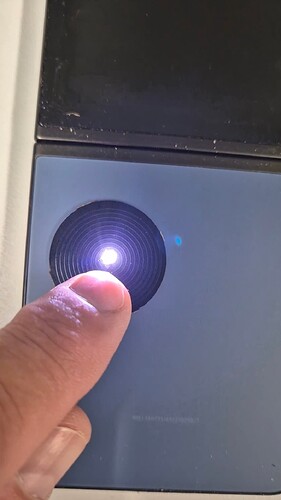

Best Spot

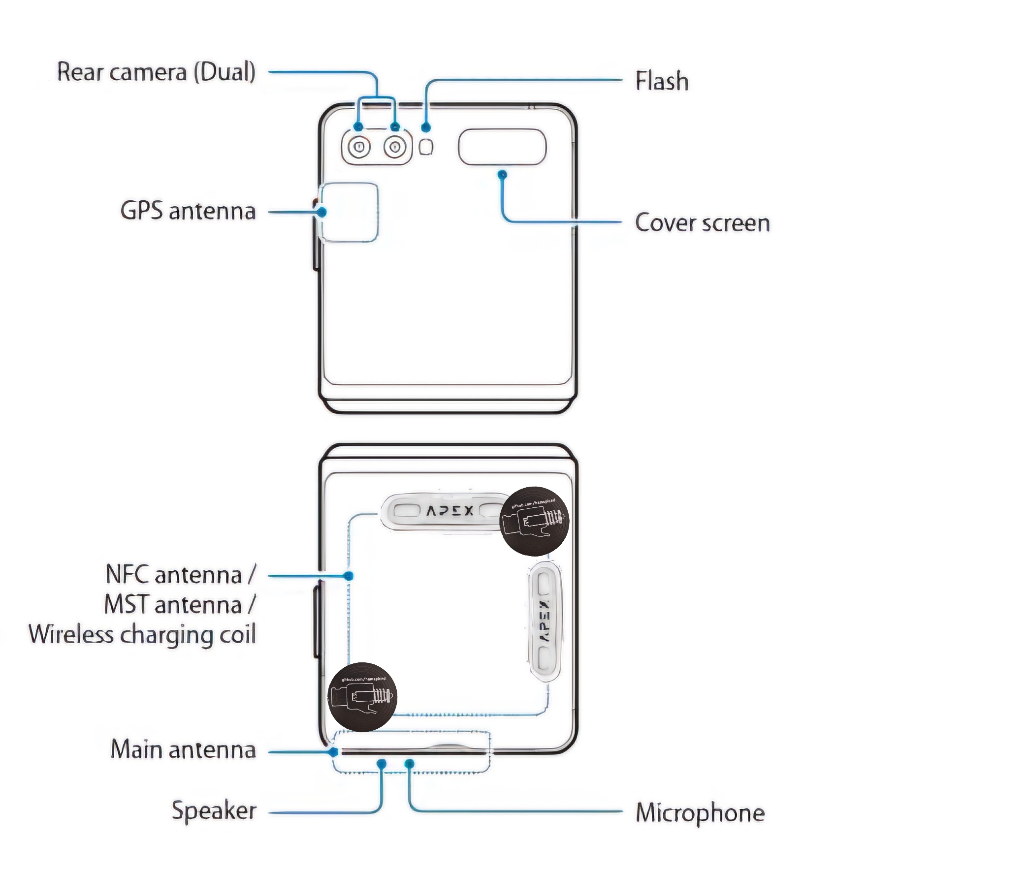

Sticker Placement
