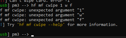

hf mf cwipe 1 w f

I updated my pm3 and grabbed a different firmware, it now returns this error
