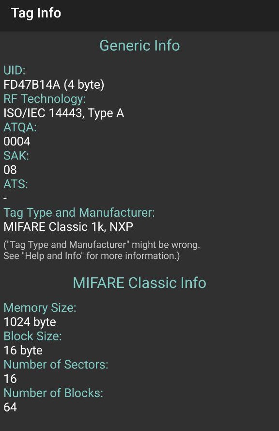

I am trying to clone a “mifare classic 1k” token using the android “mifare classic tool” app, and I am having issues with this. Wondering if someone could help me?
This is the original token:
and this is the info I got when I read it using the app:
I read it using the app and saved the dump to my phone.

mmm, to me it seems like you may be (un?)lucky enough to have a more secure system than 99% of the access control systems most people encounter.
see something like:
can you check if all your tags have the same content?

comelit are one of few staunchly anti-clone systems.
once the system recognised you presented a fob that did not carry an up-to date write it knows you cloned it and blacklisted it so not even the up to date one works.
my advice? go buy another fob from your building and don’t try and clone it. unless you are willing to constantly update both fobs after one of them has been used every single time, you aren’t gonna be cloning it.
