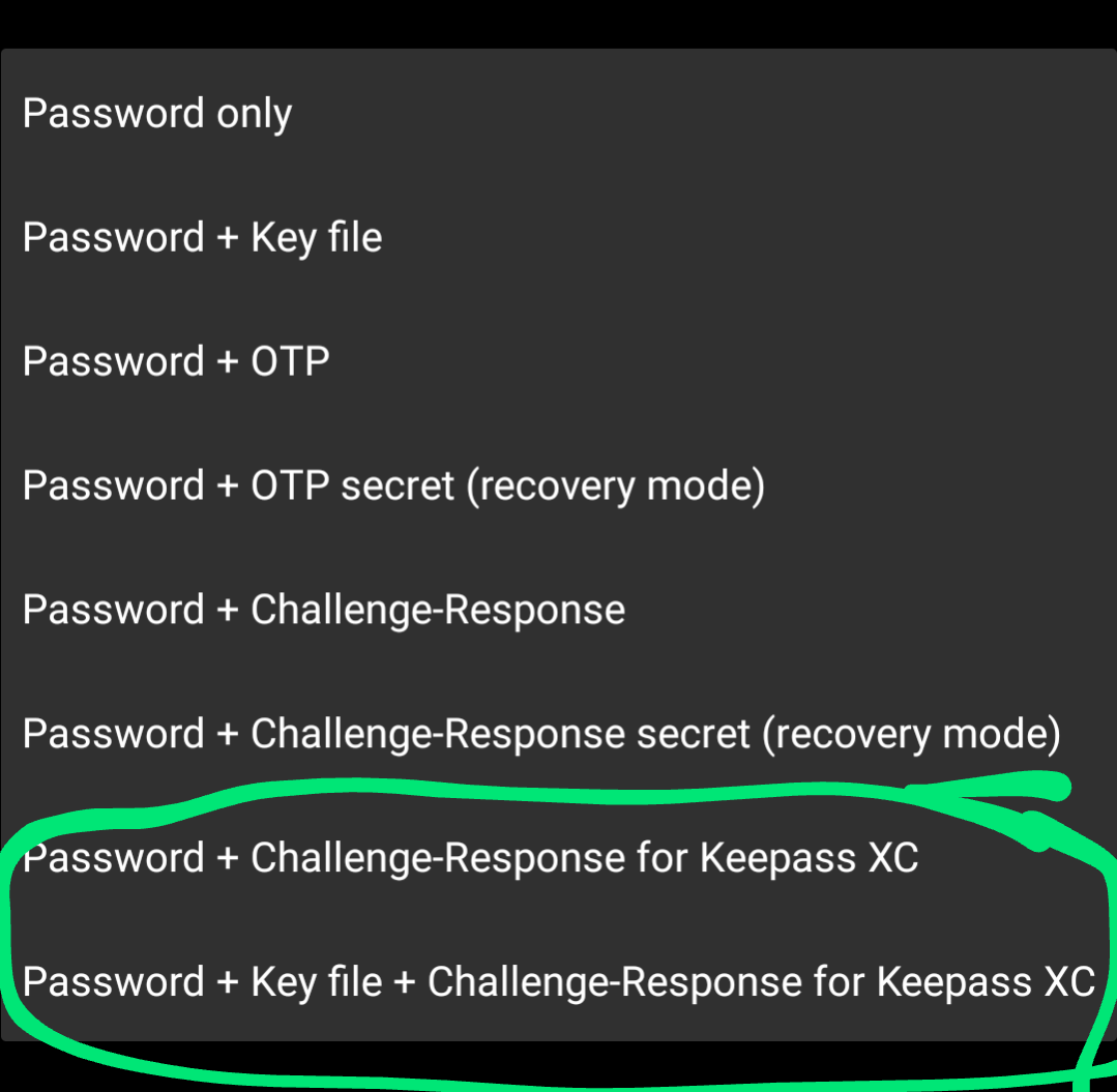

I’m just trying to figure out the best password manager to use with Apex.
Great thank you for the response! So will this app work with the HMAC-SHA1 Apex app out of the box? Or is there something else I need to do to get them working together?
You’ll have to manually push a secret to your hmac-sha1 applet through CLI or wait until the vivokey companion app is released. Thankfully @StarGate01 documented how to do this here!

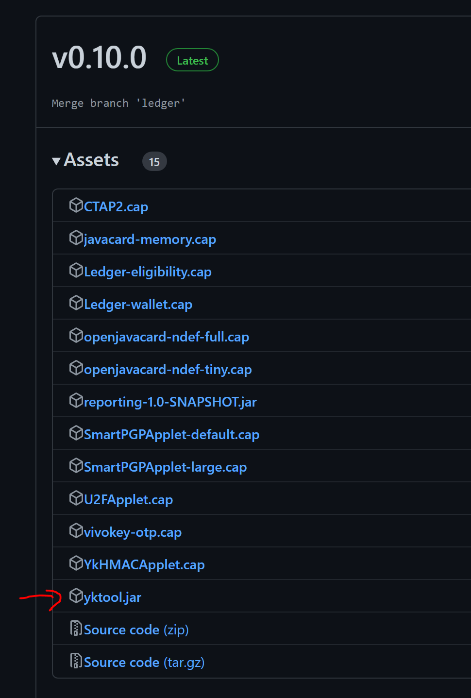

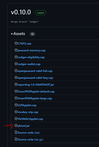

The jist of it is, you’ll need to get yktool.jar from here

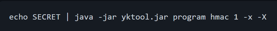

then, to program a secret to it you run the command:
and replace the word secret with a 40 character hex string (make sure to back this up somewhere safe)
