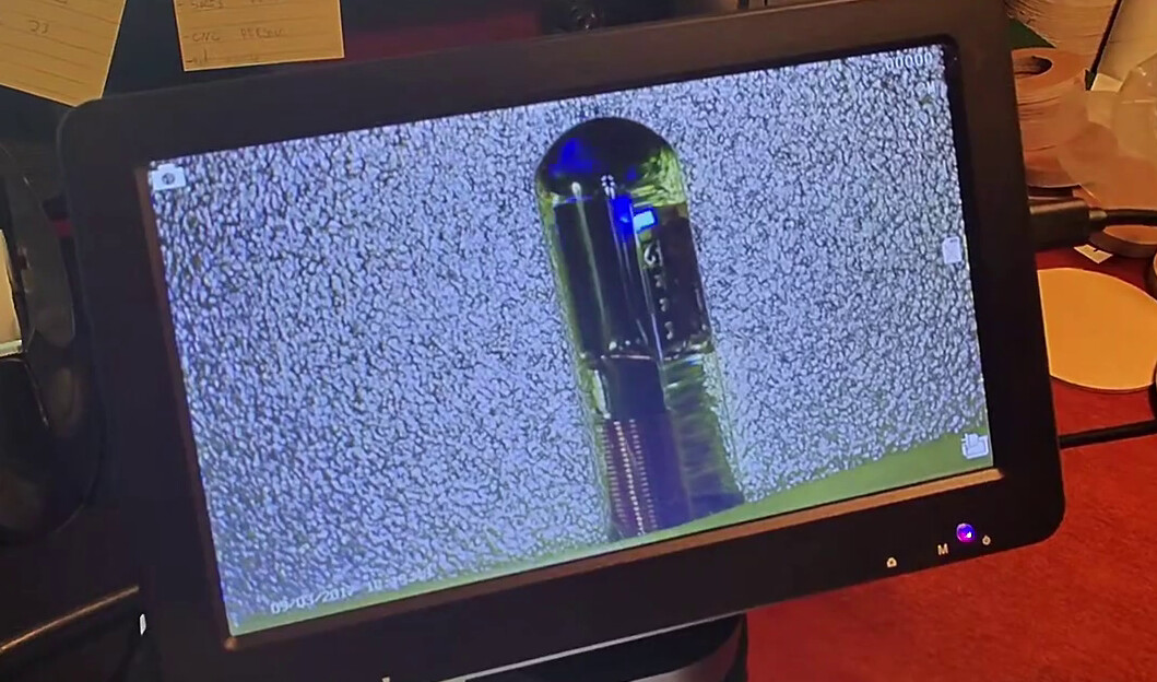

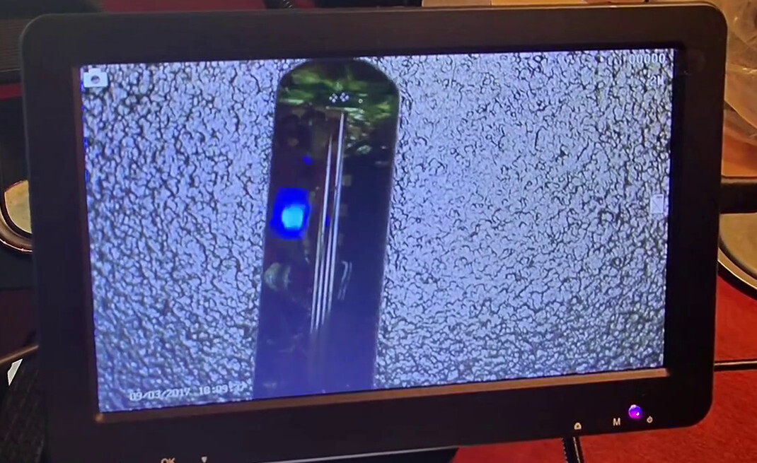

When I compared the blink brightness side by side to my xSIID, I notice that the LED on the NextV2 points directly inwards towards (what I assume is) the memory bank on the chip obstructing the LEDs brightness.
Meanwhile, the xSIIDs LED points directly to the outside of the chip giving a clear and visible blink through the skin.

I took the chips to my digital microscope to further investigate and found the exact same thing and I’ll post pics if you guys want.

Digital microscope shot of my xSIID
Digital microscope shot of my NextV2

Thanks for the videos. Based on the videos, I think the NExT v2 is actually working correctly.
The xSIID has an LED that emits light out the side of the tube. You can see this in your video as the LED is almost facing directly up into the digital microscope camera, overexposing it;
This is not ideal because the light will appear bright when facing you, and dim when facing away. The glass tube will rotate in the body so some days it might be bright and some it might not be.
The NExT v2 has a 90° LED on its carrier board, so the light emits out the “end cap”, sort of acting like a lens;
To your scope it looks dimmer but that’s because the light is mostly shooting out the glass cap, not directly up at your scope camera. In the body, this light will be scattered by tissue and be about the same visibility no matter what the rotational situation is with the glass tube.
