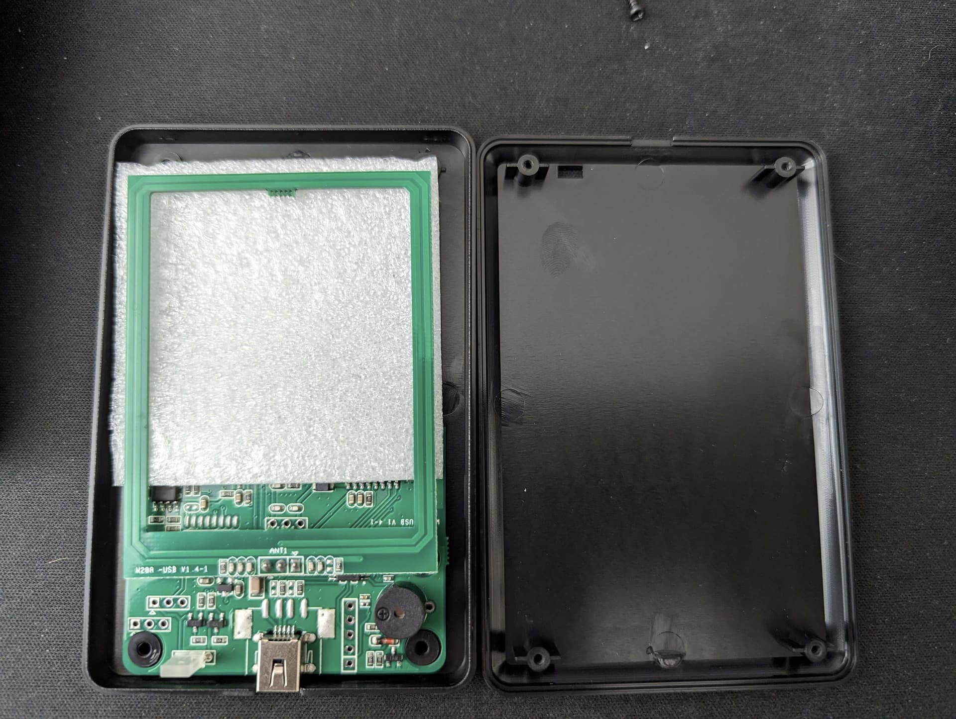

Can you post a photo of the inside of your KBR1 and confirm the antenna has not become unglued from the top casing? Sometimes the antenna coil will fall away from the underside of the top casing, increasing distance and decreasing readability with x-series implants.

Don’t believe it was glued to the top of the casing when I initially opened it. Doesn’t look to have any glue marks but does have a styrofoam insert.

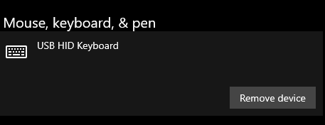

I did however remove it and my keyboard/mouse from my “Bluetooth & other devices” menu.
Then proceeded to remove all of them from the device manager menu and restarted my computer.

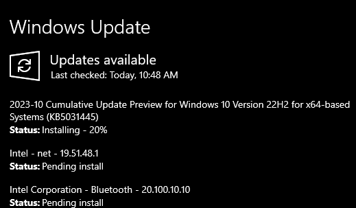

I want to say it was a mix of competing with other devices on my computer mixed with the the housing blocking it, but I’m not entirely sure? I did also apply some windows/drivers updates but I’m not sure if these would make any difference.
