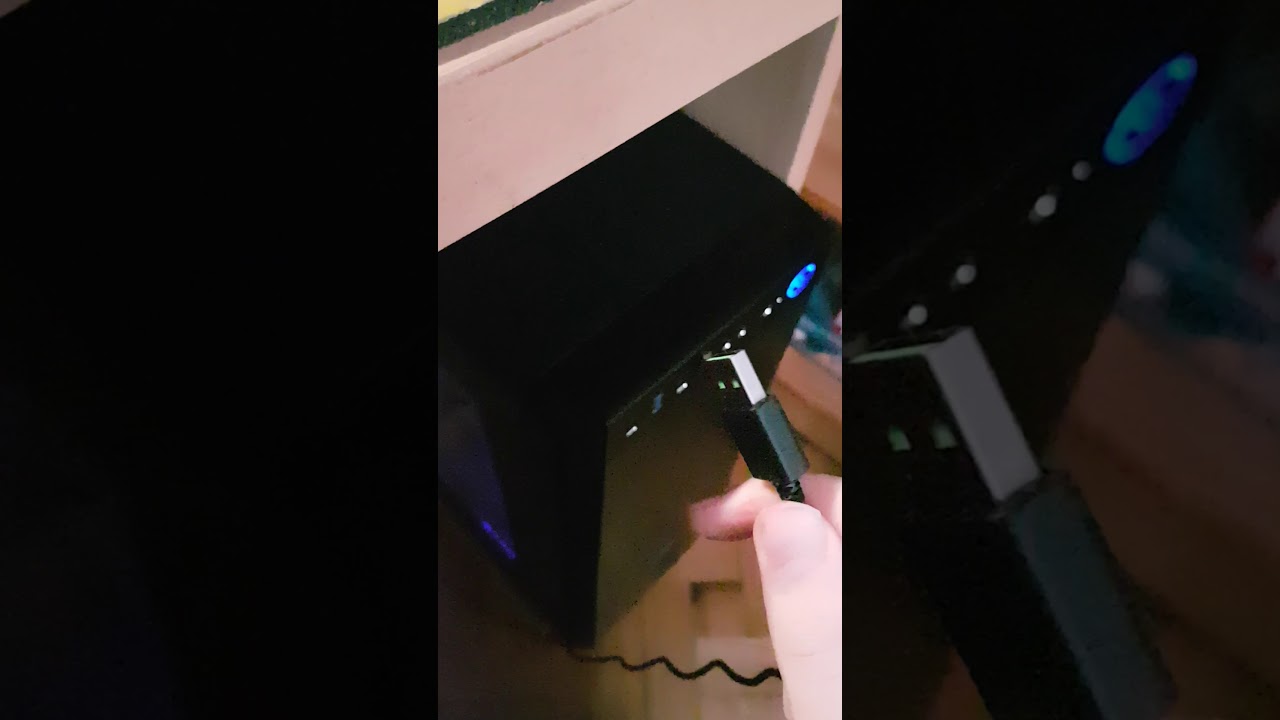

So I figured out that the cause of this problem is amd usb 3.10 extensible host controller which controls usb devices on amd systems, it has compatibility issues and when I delete them from device manager kbr1 works but other usb devices disconnects and when I reboot amd usb 3.10 extensible host controller gets installed again and kbr1 stops working. Interesting… :thinking:
I came across another person with the exact same issue but he’s using an razer Deathadder mouse, his youtube video :
I’m having this same issue, tried all the same stuff as you tried too. Hopefully one of us can figure out a way to resolve the issue. :slight_smile:
