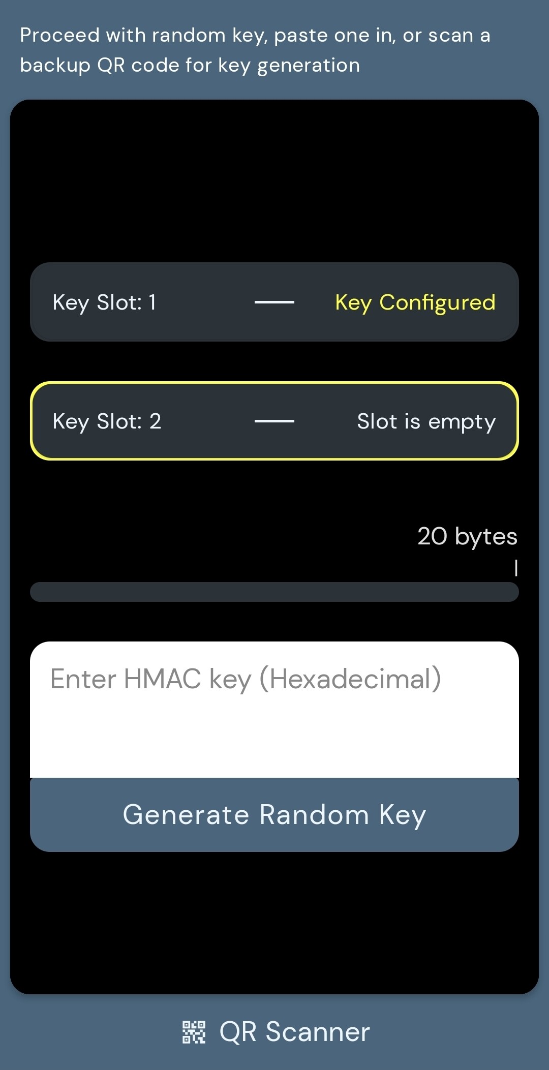

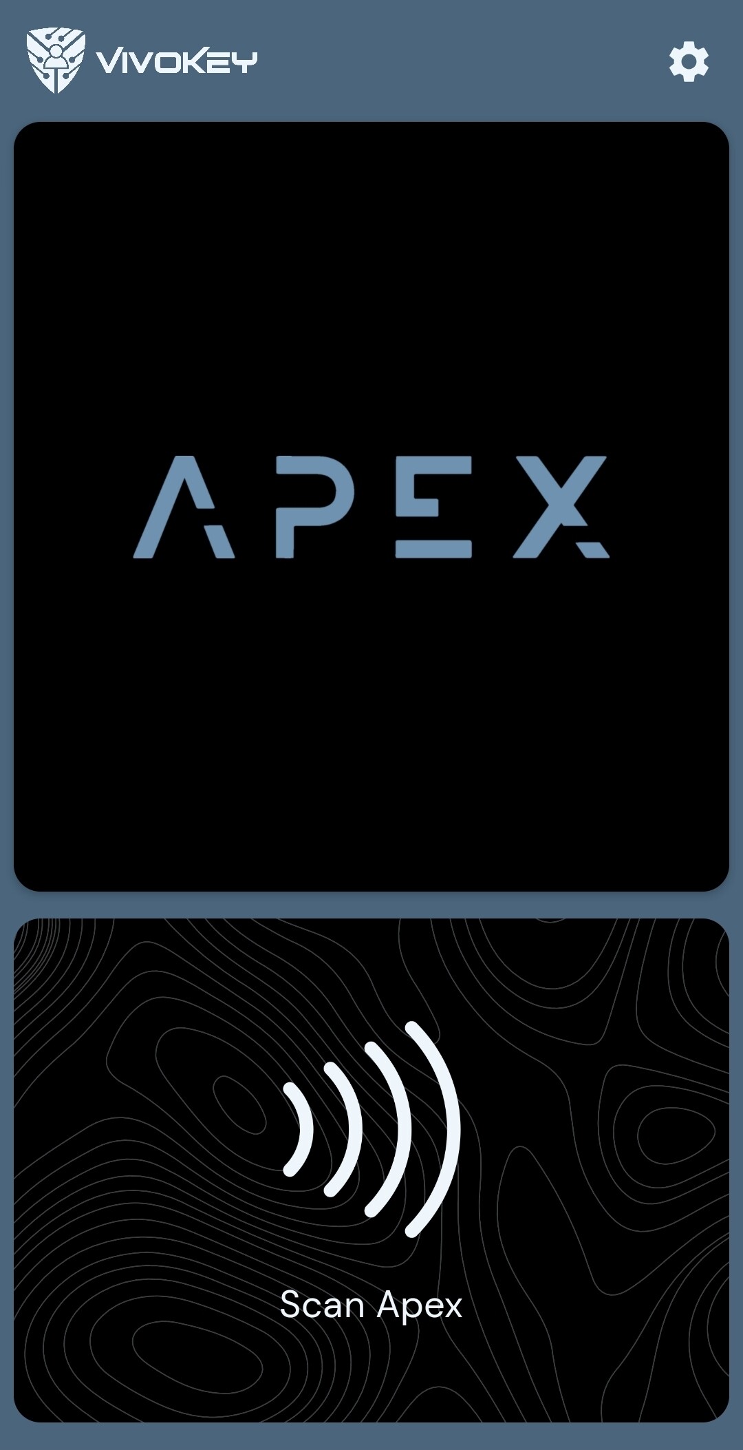

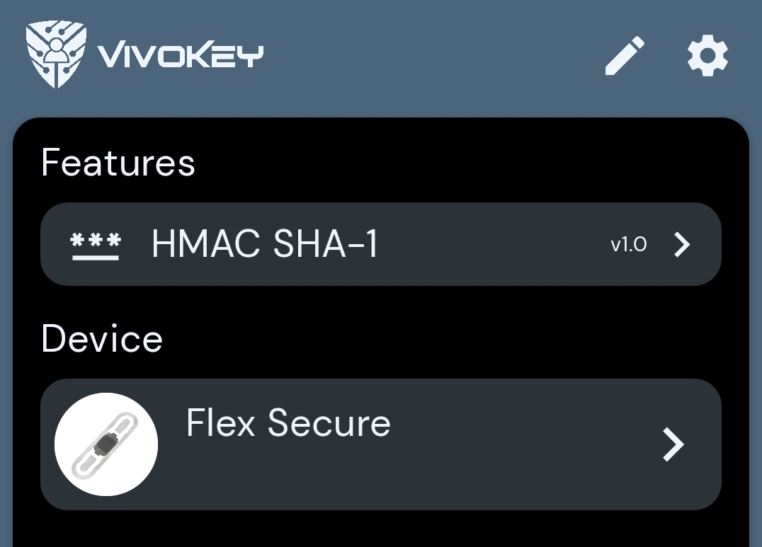

Apex Manager

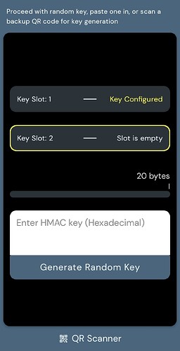

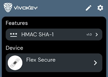

Set up your ApexFlex, FlexSecure and / or Java Test Card ( J3R180 Test Card )
Configure a key
!!!SAVE THIS KEY SOMEWHERE SAFE!!!

It only takes about 3-4 secs to access your KeePass

HMAC-SHA1 is still the protocol used, although there have been some pushes to get FIDO integration into KeePassXC as well.

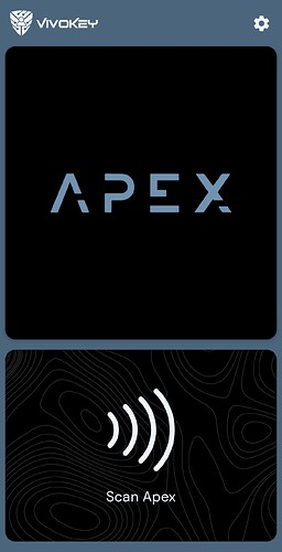

I have since added my FlexSecure setup on my Android with “Modes and routines” So when I scan my FlexSecure, My KeePass App opens, I still have to Tap unlock, then scan again to unlock, but it adds a little something extra to the user experience.
I have a few otehr set up, but the other one I use a lot is my Apex Flex which Opens my Apex manager, Scan again, and App opens.
