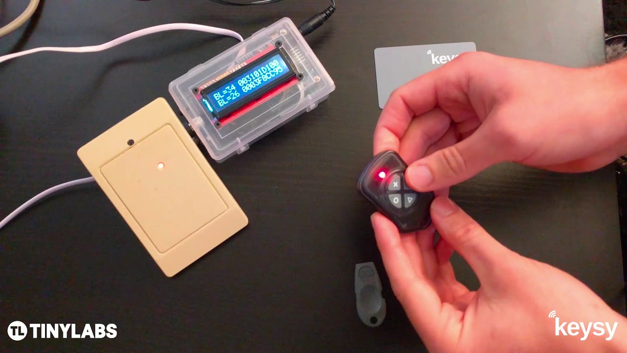

A small Key Ring style, Low Frequency 4 position Reader / Writer.
SOURCE
Tiny Labs
Hak5
Lab401
HackmoD
OzHack
CAPABILITY
First, keysy must be programmed to electronically mimic your current RFID credentials.
After that it’s as simple as holding keysy near the door reader and the keysy will electronically mimic the original RFID device.
In addition, Keysy has the ability to duplicate any previously read keycard/keyfob onto the included blank rewritable keyfob.
Frequency: 125kHz
Modulation: AM, FSK, PSK
Tag storage: 4 unique tags
Battery life: Approx. 2 years
Battery: CR2032

To be aware of:-
WARNING
The antenna and power output is NOT suitable for xSeries (xEM, NExT)
and unfortunately due to Keysy not being open-source, even if it could write to a FlexEM, the propriety writing system will prevent you from doing so
PROs
• Small
• Many mode options
• 4 button card memory
• Writable to Keysy cards and fobs ( also a CON )
• Easy to use
CONs
• Proprietary
• Not suitable to write to xSeries
PRICE
$45
Summary:
A tricky thing to rate, it is good at what it does, but loses 2 stars for having a propriety writing system requiring you to buy only compatible Keysy fobs

I neglected to mention the Keysy Easter Egg
Pressing the code up, up, down, down, left, right, left, right (+ + △ △ ○ :white_medium_square::white_medium_square:) will switch Keysy between long range and auto transmit mode. When in long range mode you will need to press a button for Keysy to emulate. After the code the LED will flash: One long red LED = long range mode, One long green LED = auto transmit mode.
