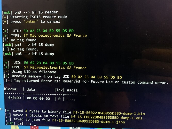

So I picked up a new front door lock. It’s the Level Touch. https://level.co/ I was hoping I’d be able to use one of my implants as a keycard for it since it has an nfc reader in the exterior of the lock. To provision new keycards you present them to your nfc enabled smartphone in the app. The picture below is a scan from a brand new card that hasn’t been setup. Being iso15693 I was hoping to use my original spark 1 but it won’t let me add it as a keycard, add to that I can’t seem to get it to scan from the lock (probably because the reader is being battery powered so it’s only sending a large pulse when it senses a large change in the field, like that of a card).
I’m open to ideas for how to get this going if you need any more info from me let me know. The wife is out with the only authorized card at the moment but when she gets back I’ll scan that and see if it’s any different after being setup.

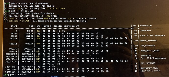

I’ve got more info, but I’m not sure what to do with it. The LF rfid stuff I could at least wrap my head around it was all pretty simple and no encryption or obscure protocols (with a few exceptions). Anyway back on point I’ve got a bit of trace data from the card that was provisioned as I used it to lock and unlock the door a couple times.

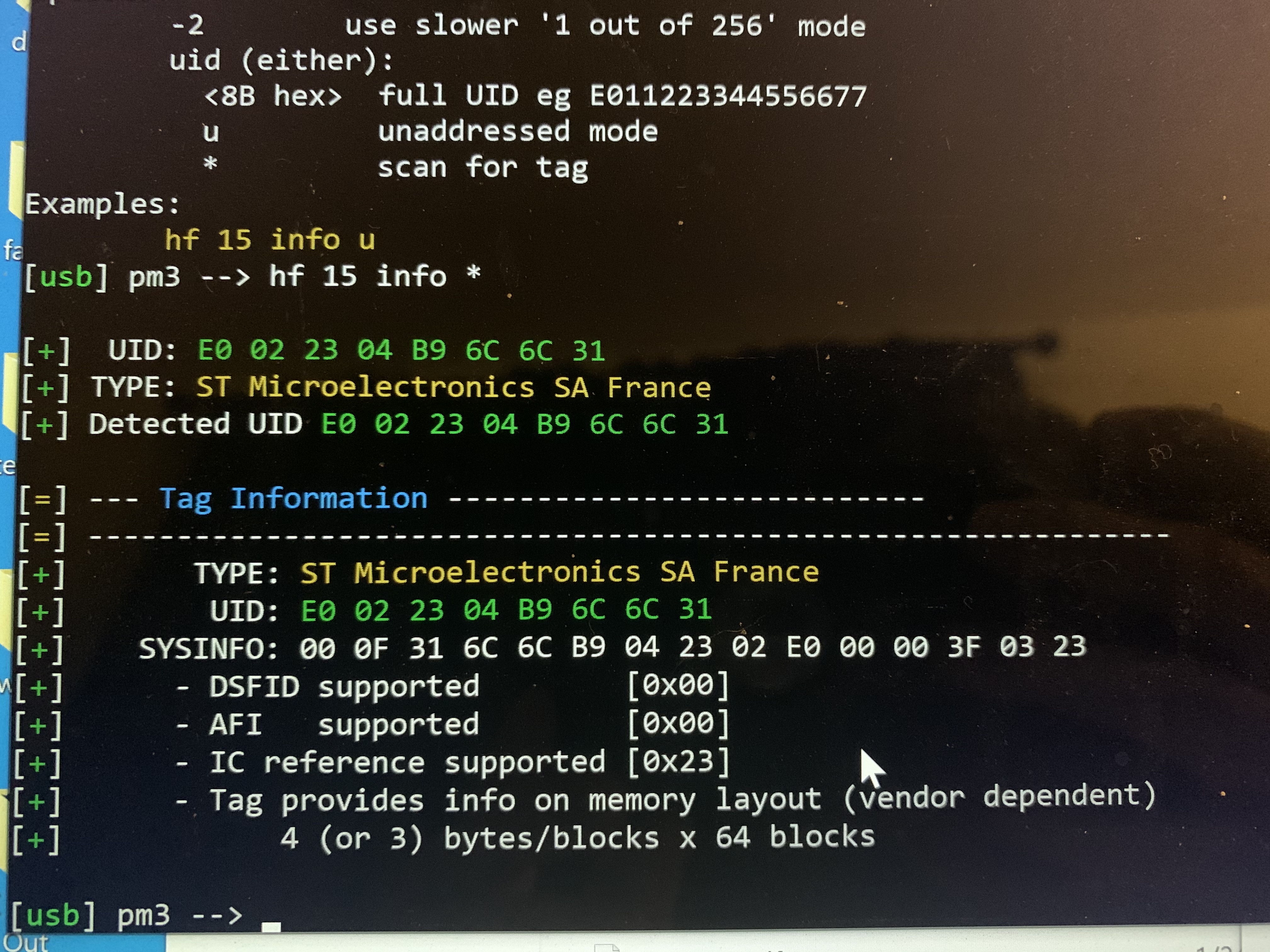

Then I’ve also got this bit of info from that same authorized card.
Like I was saying I’m totally out of my league with figuring out what to do with this info so if anyone knows what I’m looking at here let me know.

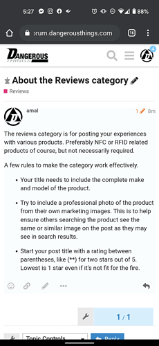

maybe we should add it to the “reviews” section ??
Between @tac0s and @Ima_Wana_Be hopefully one of them can knock a review out
