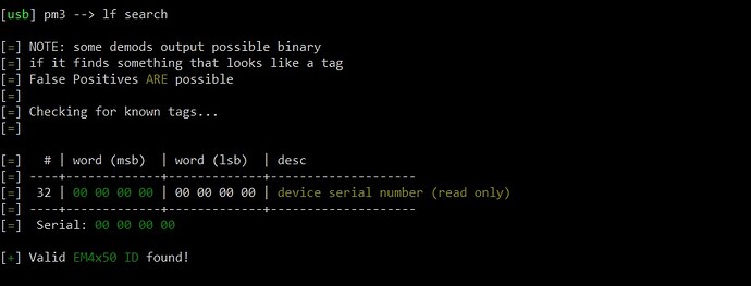

I used a proxmark3 a year or so ago and when I scanned this LF tag using “LF search” it would show the raw data that I could copy over to a blank tag.
I just ordered a new Proxmark3 and did the same LF search on that tag and got this result.
Am i doing the search incorrectly? Where is the raw data for this tag listed?
what firmware and client are you using?
Your client and firmware don’t match. You’ll have to git pull the latest and then compile the new code, and push the firmware… then your client and firmware versions should be the same.
