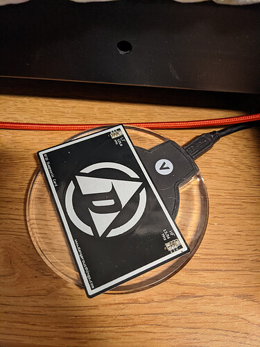

Hey so, @glass.saltmage, I happen to have the exact same wireless charger.
I threw a DT diagnostic card on it as a test.
The LF side lit up very bright, and then went out. It killed the LF side of the test card in under a second. Tested that the charger was still working (still charges my earbuds), and the card now does nothing. I tested the card with my proxmark as well, the LF side is completely dark on that card now.
Seems like this charger is VERY non-compliant, and given the distance that it killed the card at (it went out before I even set down the card), I would say it almost certainly is what killed your xLED, even if you just momentarily passed your hand over it.

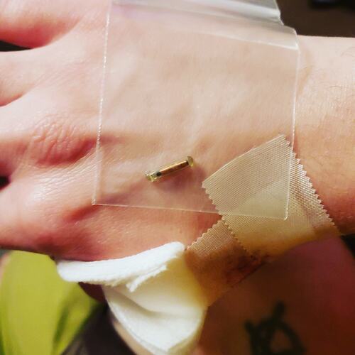

Got this pulled out last night. The glass is, as expected, entirely intact; the rattling sound is the entire antenna (and whatever it’s wound around shifting back and forth just slightly inside, having come loose from what I think is the LED in the end?
My installer was amazing and put my xm1 in the space where he pulled this sucker out from.

I put it in the mail yesterday, but I do have a photo I took of it after the uninstall. I don’t feel like I know what I’m looking at well enough to provide any meaningful conjecture. :man_shrugging:
picture is removed LF xLED in a plastic bag, on top of the back of my hand.
Is that a xled or a XFD?
its this: https://dangerousthings.com/product/xled/
