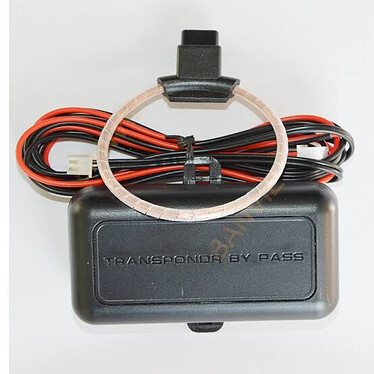

Well, there is a solution, but probably not the way you envisage, I am assuming you have an antenna coil at the ignition you are trying to bypass/authorise with your chip…
IF i am correct and that is what you are thinking of, then a combination of and xAC and an transponder bypass will probably achieve what you are trying to
[AliExpress Link]
(https://a.aliexpress.com/_mNqYbR8)
