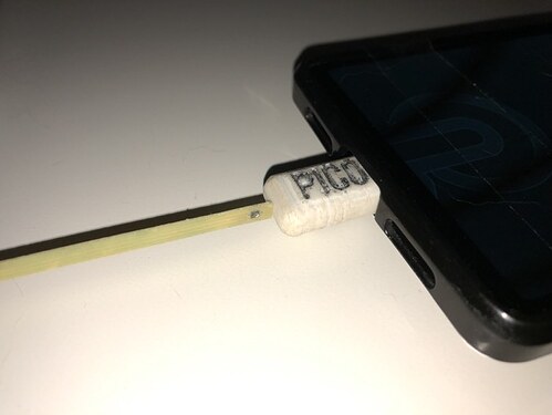

Mine arrived today.
Amazing. Love the wee case.
Huh the tip came loose :neutral_face:?
You can thank @invalid_signal for that! The first ~20 people got one, I’m all out now.
