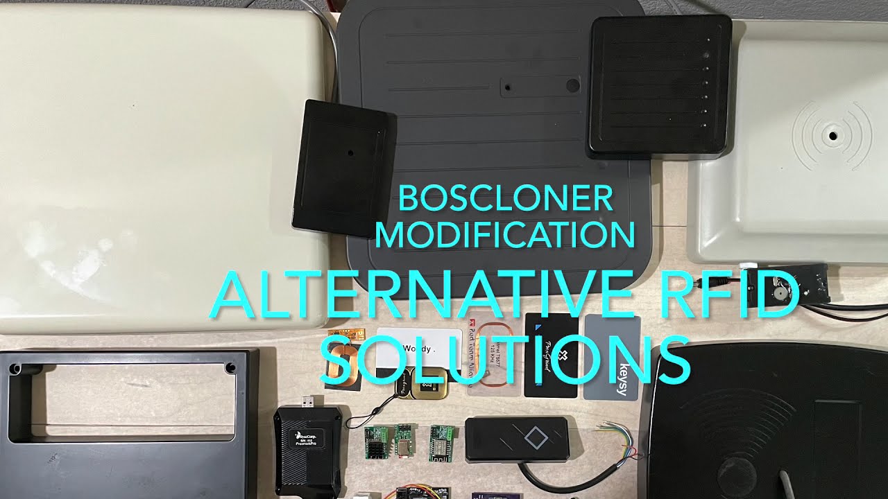

I have used several versions of this and they work great. To increase range I recommend moving the guts to another part of the bag and comment the antenna by extending the leads to the reader.
Here is an example of modifications and range extensions I do.
hey i came across your video around this time last year. sourcing a boscloner wasnt in my range, do you know if there is any open source equivilant? i have an HID-R90 i was going to use for this project but abandoned it until i could find something.
