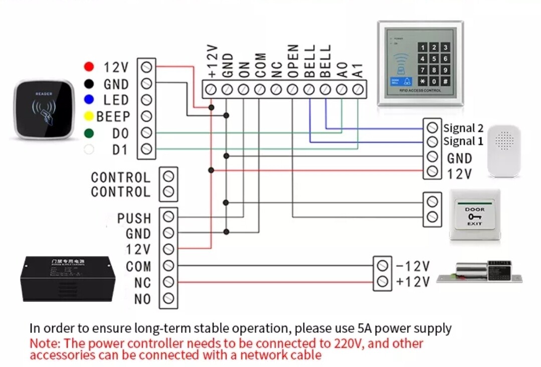

I had the reader connected to a power supply @ exactly 12V
If you want to use this reader, you will need to attach it to some form of access system

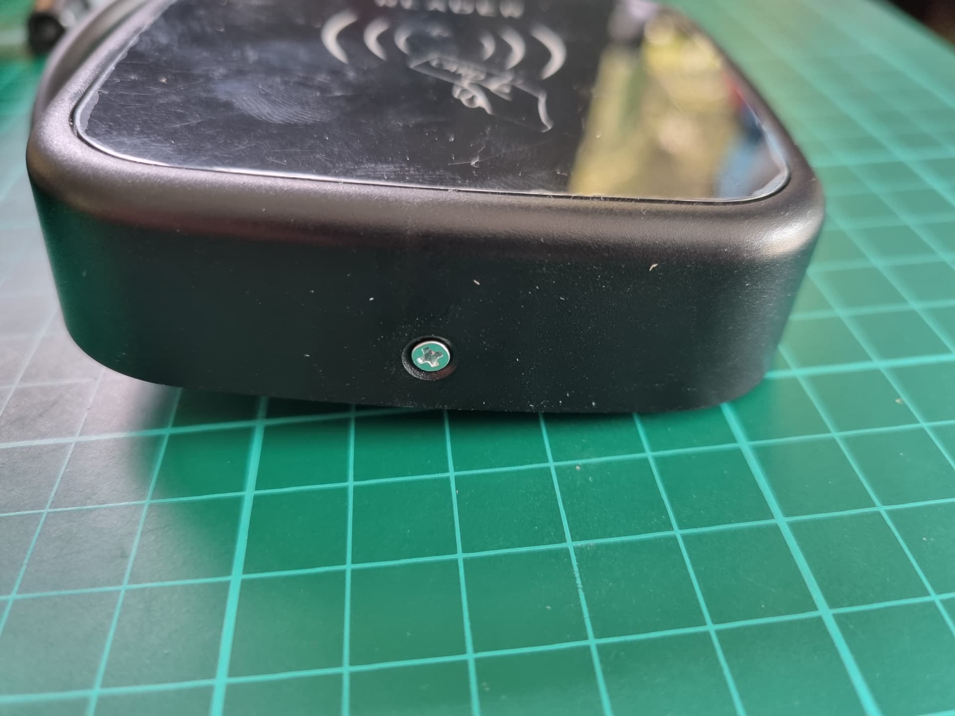

IP68 Waterproof…apparently

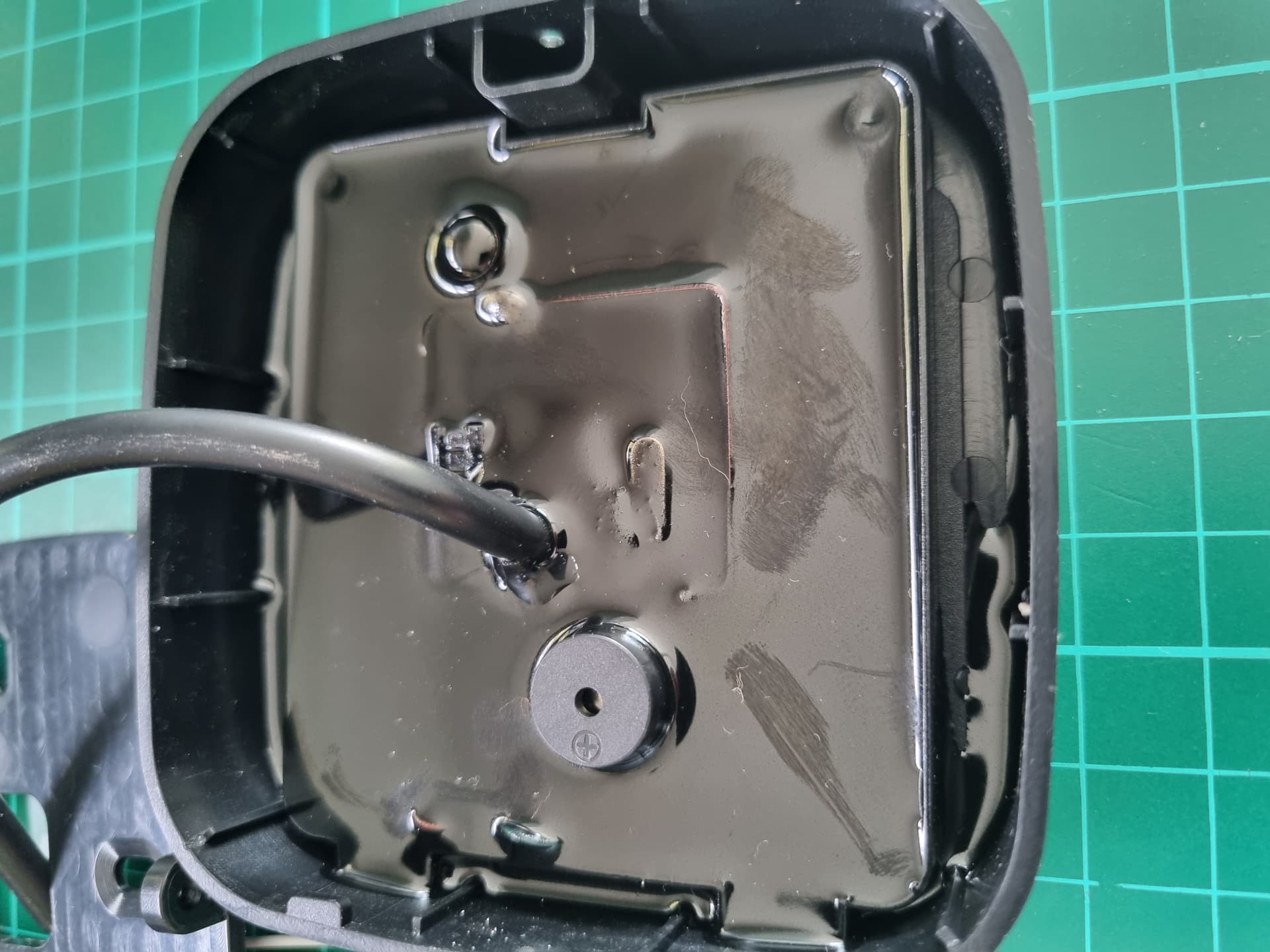

Remove the small Phillips screw, then gently pry open
The Piezo Buzzer is mounted on the underside of the board to get access to, glue fill or remove…
