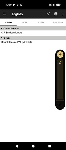

Somewhat related to this, but another tag i was planning on was my Work access control tag. When i scan it, it is also a “Mifare Classic EV1” in tag info.
What implants a compatible with that? my research indicates possibly any of the DESfire EV1 units are, however i would need to get the building control people to enroll the chip into their system for it. Would something like the xDF of the flexDF suit this application? I dont have my tag currently, so had a workmate scan theirs, and am awaiting the UID to determine if its 4 or 7 bytes, as from what I have read, this also factors in if the implants are compatible with doing this.

Most access control systems which allow enrollment of 3rd party transponders are also open enough to allow different types of transponders to be registered / enrolled. Check with your access control people for best results.
On the other hand, if the access system is closed and leverage the security features of chips like Mifare Classic EV1 to trap their customers into only being able to buy compatible transponders from them, then even having a Mifare Classic EV1 implant would not help you.
Best to start by checking with your people, then we can work to a solution.

Generally yes because pretty much every RFID application out there just assumes you are using the transponder only with that one application.. so things like securing the transponder with keys etc. generally leave it useless for other applications. Only access applications that use the completely insecure method of leveraging the transponder UID only would leave the rest of the memory unsecured for your personal use.
Absolutely yes, but I guarantee only 0.00481% of any actual management level personnel or c-suite jagoffs responsible for overseeing security have any concept of this, and instead think “security” means taking back your physical transponder when you leave. It’s depressing how unintelligent these people are about such things.
I just scanned my work tag, its a 4 byte uuid. So that’s a win.
