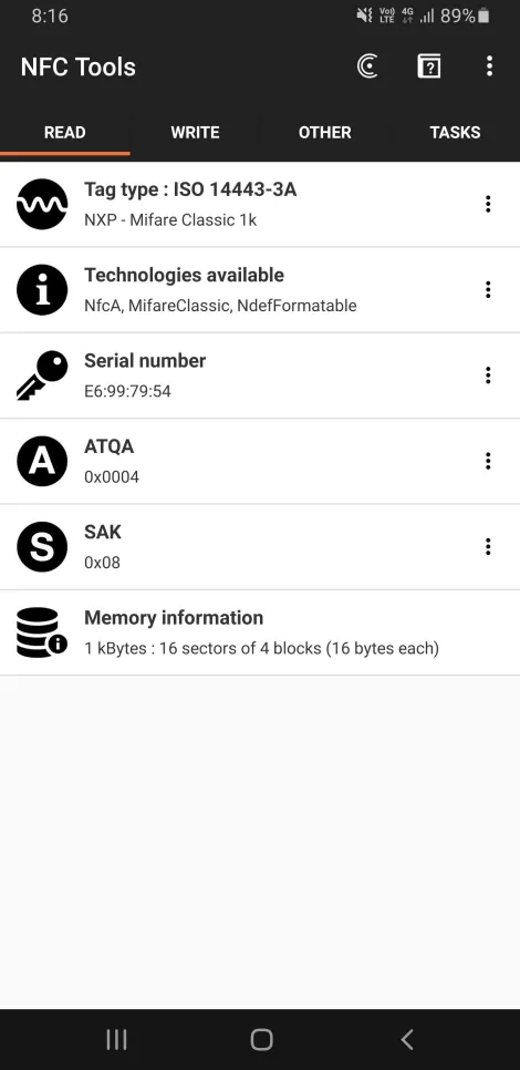

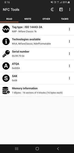

When I scan it using either NFC tools on my android, it shows up as a Mifare Classic 1K. See the image below.
But i cant find enough info out there on using the MCT to determine if it has actually read all the card sectors or not. When i scan it, I can see it show up “1492 keys loaded” and it seems to take a long time to make any “key mapping progress”. So, i think its trying to bruteforce it. but im not 100% sure.
Well there’s your problem right there.
LET IT BE KNOWN HENCEFORTH !!!
NFC TOOLS SUCKS DONKEY DICKS FOR CHIP IDENTIFICATION
THAT IS ALL.
Use TagInfo and post the XML file.

Ah, i just scanned it using Taginfo, and it shows it as a EV1. So I assume thats why it cant be cloned?
Yeah. Unfortunately.
