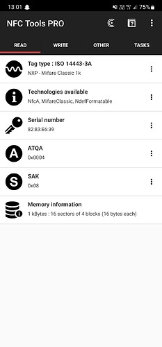

The main purpose of it would be to unlock the door at my surfclub. I will also upload a picture of what nfc tools reads from my bracelet. Can this nfc tag be cloned to tye xsiid?

Unfortunately not, the xSIID’s not really set up for cloning credentials. Fortunately however, it should be clonable to the xMagic, xM1/FlexM1, or the FlexMT

Ok, so after a long time waiting for my Proxmark3 to come in I did some trial and error. I’ve managed to clone my badge and copy it to a tag succesfully.
These are the specs of the copied tag that worked:
