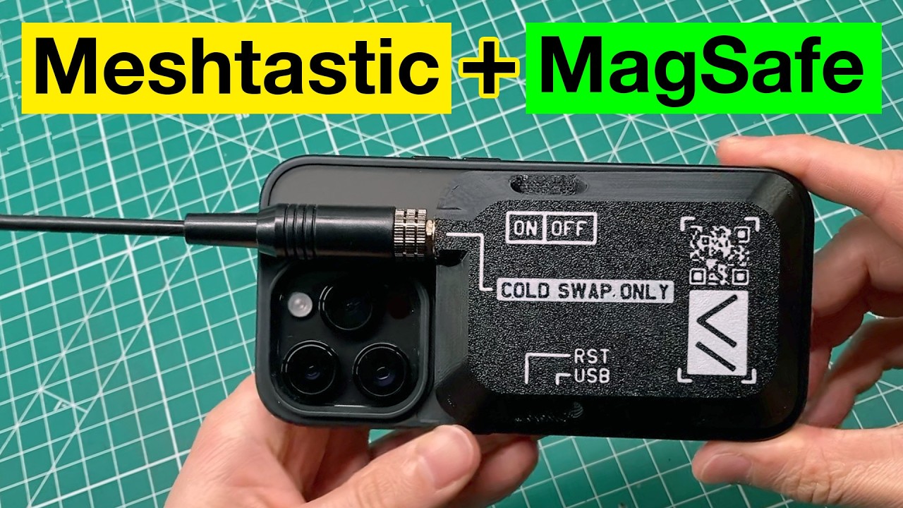

This is a pretty neat add on
A MagSafe charging mod would make it even better
