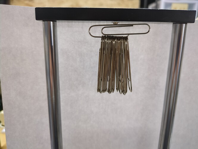

If you’re in the market for a finger magnet, this one is worth checking out and sporting an initial TiN coating under the bioresin. At just under half a millimeter shorter in height than the m0426a, it is the smallest option we currently offer with the highest rating available: n55. At 1600G it isn’t as strong as its bigger, n52 brother, which comes in at 2110G, but it certainly isn’t a slouch with nearly double the field strength to mass ratio.
But what about lifting?
20, 50mm paperclips (1.03g/ea)
