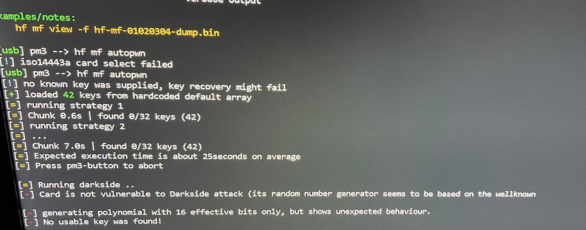

I was trying to write the magic ring using Hf MF restore —1k -f file1 -k file2 and I’m not exactly sure what I’ve done I’m new to this but can someone tell me if I bricked it?
(Forgive the poor quality I had to take photos on my phone.)

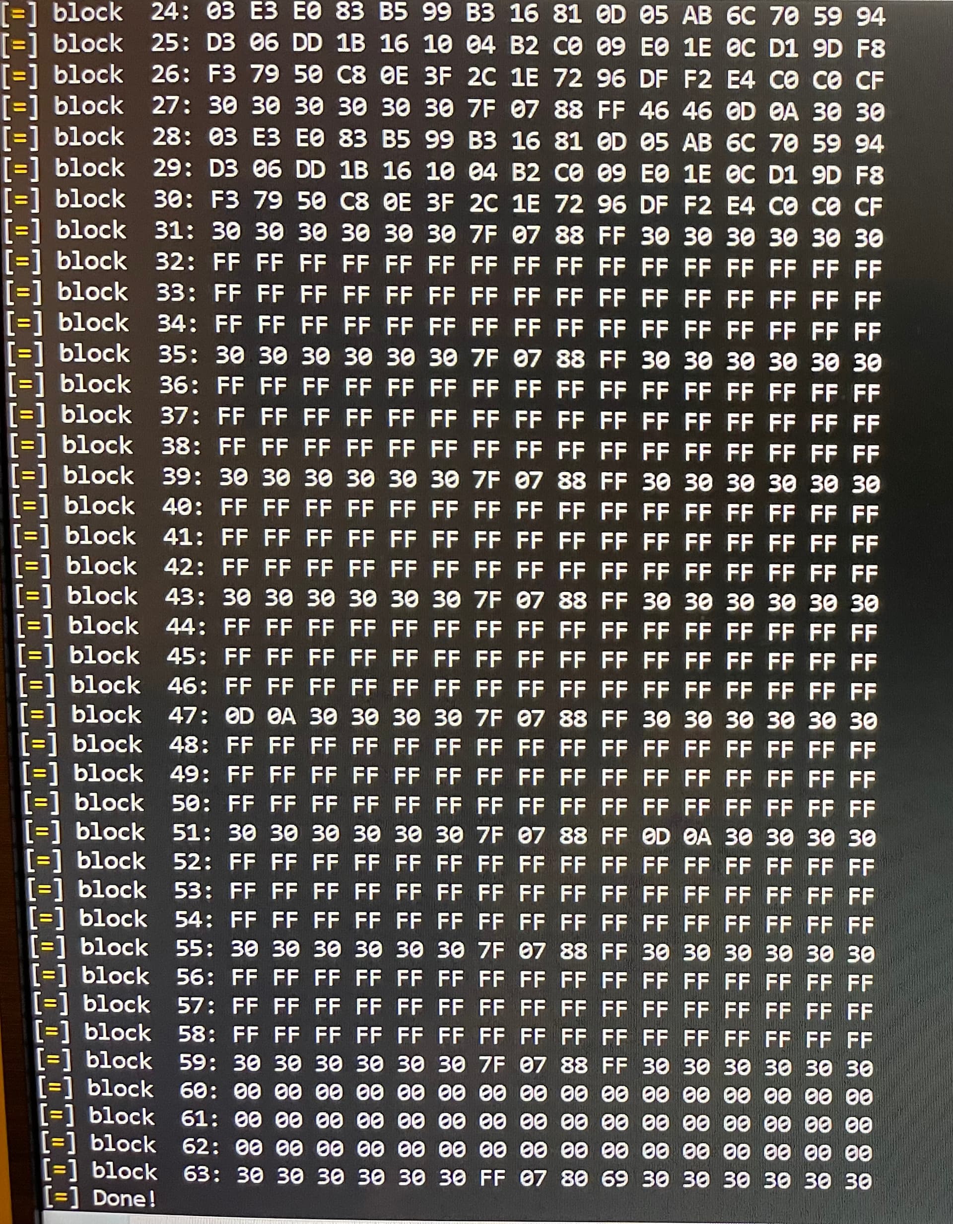

I just don’t think succeeded. I’m pretty sure the restore command works with Gen 1A magic mifare chips and the ring is a gen2.
Basically this means that sector 0 probably was not written to, but the rest of the sector is very well may have.
The difference is that a Gen 1A chip uses a magic backdoor command to open all sectors for writing regardless of access bit settings. A Gen 2 chip does not have a back door command but simply lets you write to all sectors using normal wire commands, including sector 0.
I haven’t checked the restore command in a while… there might be an option for supporting Gen 2 chip types
cload is for gen1, restore is for gen2 chief
So do you think it’s something I can fix or should I get a new one?
sorry there wasn’t enough info in the screenshots to show what’s happening after you attempted to clone to the ring. are all the sectors locked or something?
can you try to scan it with
and share the full scan data?
Yeah… hate to be the bearer of bad news, but there’s a lot of errors in there. I’ll try to break it down.
Going of the dump from your screenshot:
Sector 0 seems okay.
Sectors 1-15 (everything else) are toast.
Your access bits for these sectors got all kinds of messed up, probably from a failed write. Unfortunately, they seem set in a state where you likely won’t be able to fix it. The gen2 chip in the Magic Ring can’t be reset with backdoor commands, so you gotta be careful what you write to it.
Basically, you should still be able to change the UID as it’s in sector 0 and that sector should still be writable with keys 314146464341 for A and 303030300D0A for B. Everything else may be hit or miss, since the access bits and their inverse don’t match, which I’m not entirely sure can be fixed. I’ll do some looking later when I’m home.
Sector 0
Key A: 314146464341
Key B: 303030300D0A
Access Bits (Hex): FF078069
Access Bits (Binary): 1111 1111 0000 0111 1000 0000 0110 1001
C1: 0000
C2: 0000
C3: 1000
C1i: 1111
C2i: 1111
C3i: 0111
✓ C1i is the inverse of C1.
✓ C2i is the inverse of C2.
✓ C3i is the inverse of C3.

X No Decrement/Transfer/Restore Access
Block 41: 000
✓ Read by Key A|B
✓ Write by Key A|B
✓ Increment by Key A|B
✓ Decrement/Transfer/Restore by Key A|B
Block 42: 000
✓ Read by Key A|B
✓ Write by Key A|B
Block 43 (Sector Trailer): 000
Key A
X No Read Access
✓ Write by Key A
Key B
✓ Read by Key A
✓ Write by Key A
Access Bits
✓ Read by Key A
X No Write Access
Sector 11
Key A: 0D0A30303030
Key B: 303030303030
Access Bits (Hex): 7F0788FF
Access Bits (Binary): 1111 1110 0000 1111 0001 0001 1111 111
C1: 0000
C2: 0001
C3: 0001
C1i: 1110
C2i: 1111
C3i: 1111
X C1i is NOT the inverse of C1.
X C2i is NOT the inverse of C2.
X C3i is NOT the inverse of C3.
Block 44: 011
✓ Read by Key B
✓ Write by Key B
X No Increment Access
Block 45: 000
✓ Read by Key A|B
✓ Write by Key A|B
Block 46: 000
✓ Read by Key A|B
✓ Write by Key A|B
Block 47 (Sector Trailer): 000
Key A
X No Read Access
✓ Write by Key A
Key B
✓ Read by Key A
✓ Write by Key A
Access Bits
✓ Read by Key A
X No Write Access
Sector 12
Key A: 303030303030
Key B: 303030303030
C1: 0000
C2: 0001
C3: 0001
C1i: 1110
C2i: 1111
C3i: 1111
Block 48: 011
✓ Read by Key B
✓ Write by Key B
Block 49: 000
✓ Read by Key A|B
✓ Write by Key A|B
Block 50: 000
✓ Read by Key A|B
✓ Write by Key A|B
Block 51 (Sector Trailer): 000
Key A
X No Read Access
✓ Write by Key A
Key B
✓ Read by Key A
✓ Write by Key A
Access Bits
✓ Read by Key A
X No Write Access
Sector 13
Key A: 303030303030
Key B: 303030303030
C1: 0000
C2: 0001
C3: 0001
C1i: 1110
C2i: 1111
C3i: 1111
Block 52: 011
✓ Read by Key B
✓ Write by Key B
Block 53: 000
✓ Read by Key A|B
✓ Write by Key A|B
Block 54: 000
✓ Read by Key A|B
✓ Write by Key A|B
Block 55 (Sector Trailer): 000
Key A
X No Read Access
✓ Write by Key A
Key B
✓ Read by Key A
✓ Write by Key A
Access Bits
✓ Read by Key A
X No Write Access
Sector 14
Key A: 303030303030
Key B: 303030303030
C1: 0000
C2: 0001
C3: 0001
C1i: 1110
C2i: 1111
C3i: 1111
Block 56: 011
✓ Read by Key B
✓ Write by Key B
Block 57: 000
✓ Read by Key A|B
✓ Write by Key A|B
Block 58: 000
✓ Read by Key A|B
✓ Write by Key A|B
Block 59 (Sector Trailer): 000
Key A
X No Read Access
✓ Write by Key A
Key B
✓ Read by Key A
✓ Write by Key A
Access Bits
✓ Read by Key A
X No Write Access
Sector 15
Key A: 303030303030
Key B: 303030303030
Access Bits (Hex): 7F078069
Access Bits (Binary): 1111 1110 0000 1111 0000 0000 1101 001
C1: 0000
C2: 0000
C3: 0000
C1i: 1110
C2i: 1111
C3i: 1111
Block 60: 000
✓ Read by Key A|B
✓ Write by Key A|B
Block 61: 000
✓ Read by Key A|B
✓ Write by Key A|B
Block 62: 000
✓ Read by Key A|B
✓ Write by Key A|B
Block 63 (Sector Trailer): 000
Key A
X No Read Access
✓ Write by Key A
Key B
✓ Read by Key A
✓ Write by Key A
Access Bits
✓ Read by Key A
X No Write Access
Thank you for the information, I figured as much I’ll buy another one and hopefully get it to work the second time around.
