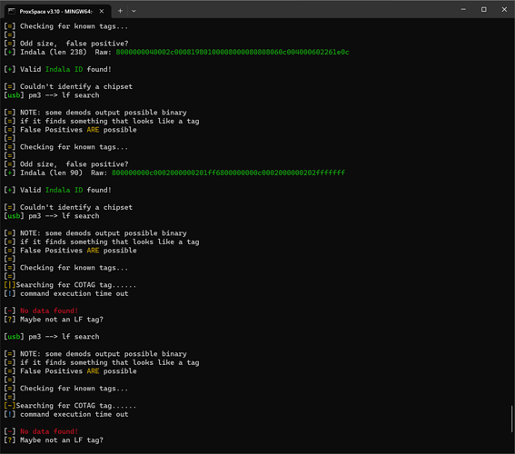

Thanks for the help - I’ve tried this, with no luck. Without moving my finger, doing an lf search gives me the following (with lf tune showing 14mV):
I did try the link you posted about reviving a bricked one. That didn’t seem to help - couldn’t detect it with lf t5 detect or p1detect. Did the writes, and still nothing. And it seems even if I get tune down to 14mV, search is hit or miss in finding data, and always says false positive.
