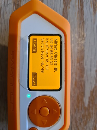

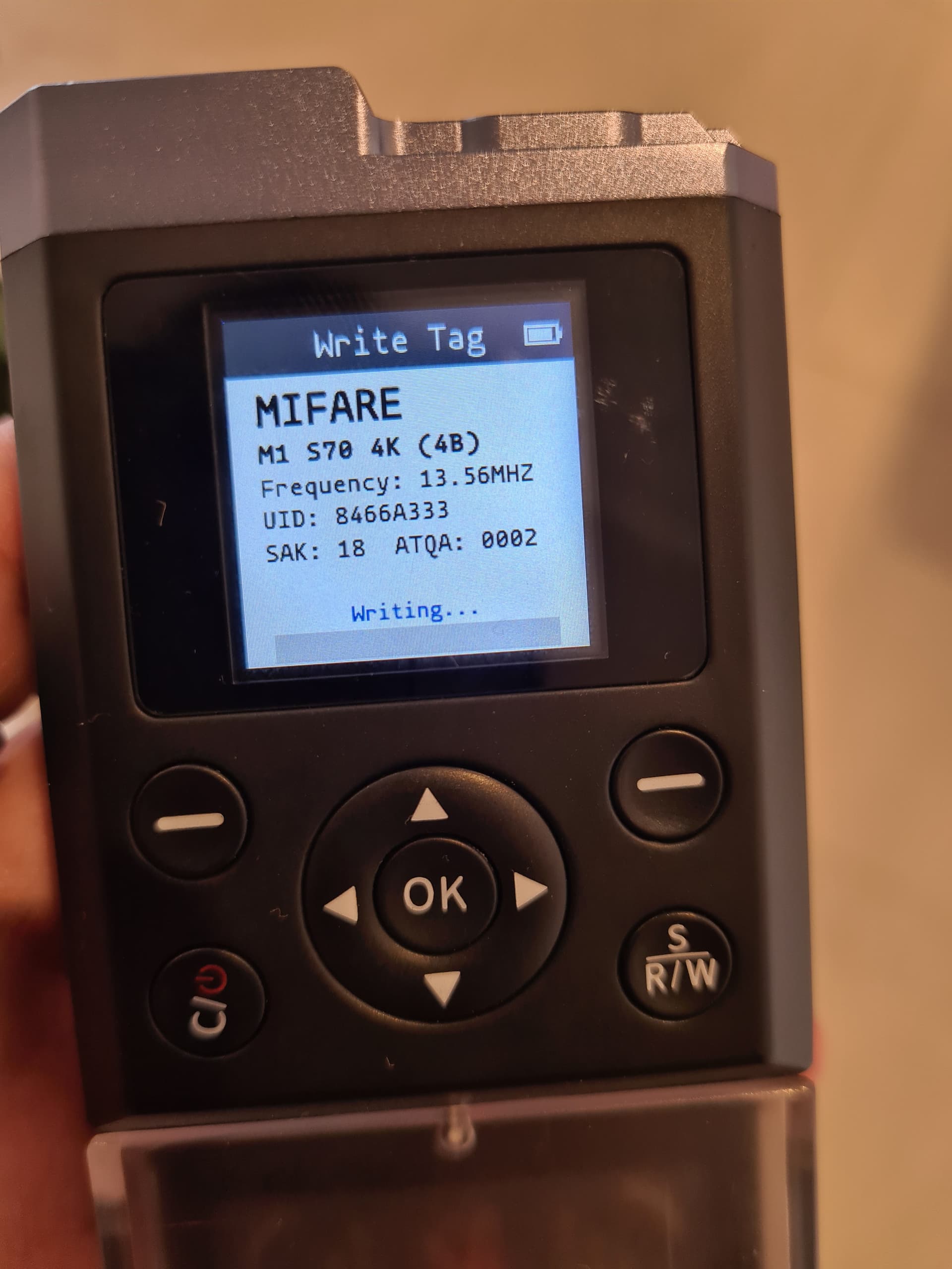

Bought the ring and it just arrived, I just see one dot not the one with 2 and 1 I guess , but sold as m1 + t5577 , trying to write a M1 S70 4K (4B) with icopyX with no luck.
Hope anyone knows what I’m doing wrong, thanks in advance

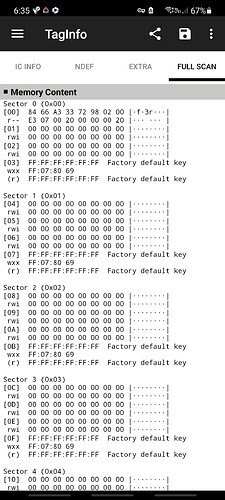

Can you try scanning it with your phone, with something like NFC Tools orTagInfo to see if it can tell you what chip type it is?
We received a batch with only one dot on them and decided it’s a better design … more subtle… the mifare chip should be exactly opposite the single dot side.
NfcA, MifareClassic, NdefFormatable
NXP - Mifare Classic 1k
Thanks it do looks better and I can see it have the technology, just can it support m1 S70 4k (4b) maybe it’s the 4k what’s failing right?

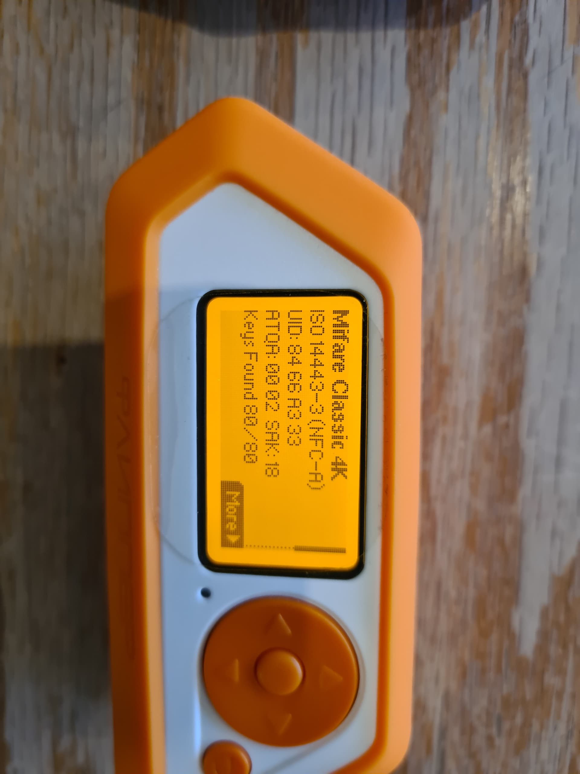

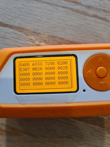

Does the card you’re trying to copy have a 4 byte uid or a 7 byte?
It isn’t using all but I don’t know if I can clone it with this
First time trying a 4k on a 1k , don’t know if it could even be possible.
The 4k is larger than the 1k, so I don’t think a full copy will work, you should be able to manually set the UID on your ring though, which may work for you
Best way to do that, first time doing this lol, got proxmark3 but haven’t even try it lol ? I guess since the last digits are just 0000 it would work
Since the ring is Gen2 you can just write to block 0 directly with the UID, how you do this varies with what tool you use, if you want to use the PM3 you’ll use the
hf mf wrbl
Command
If you get a taginfo scan of the tag you’d like to clone the UID to, I can give you the full command you could try

now run this?
Now you would run
hf mf wrbl --blk 0 -d 8466A3339E0804006263646566676869
on the ring
