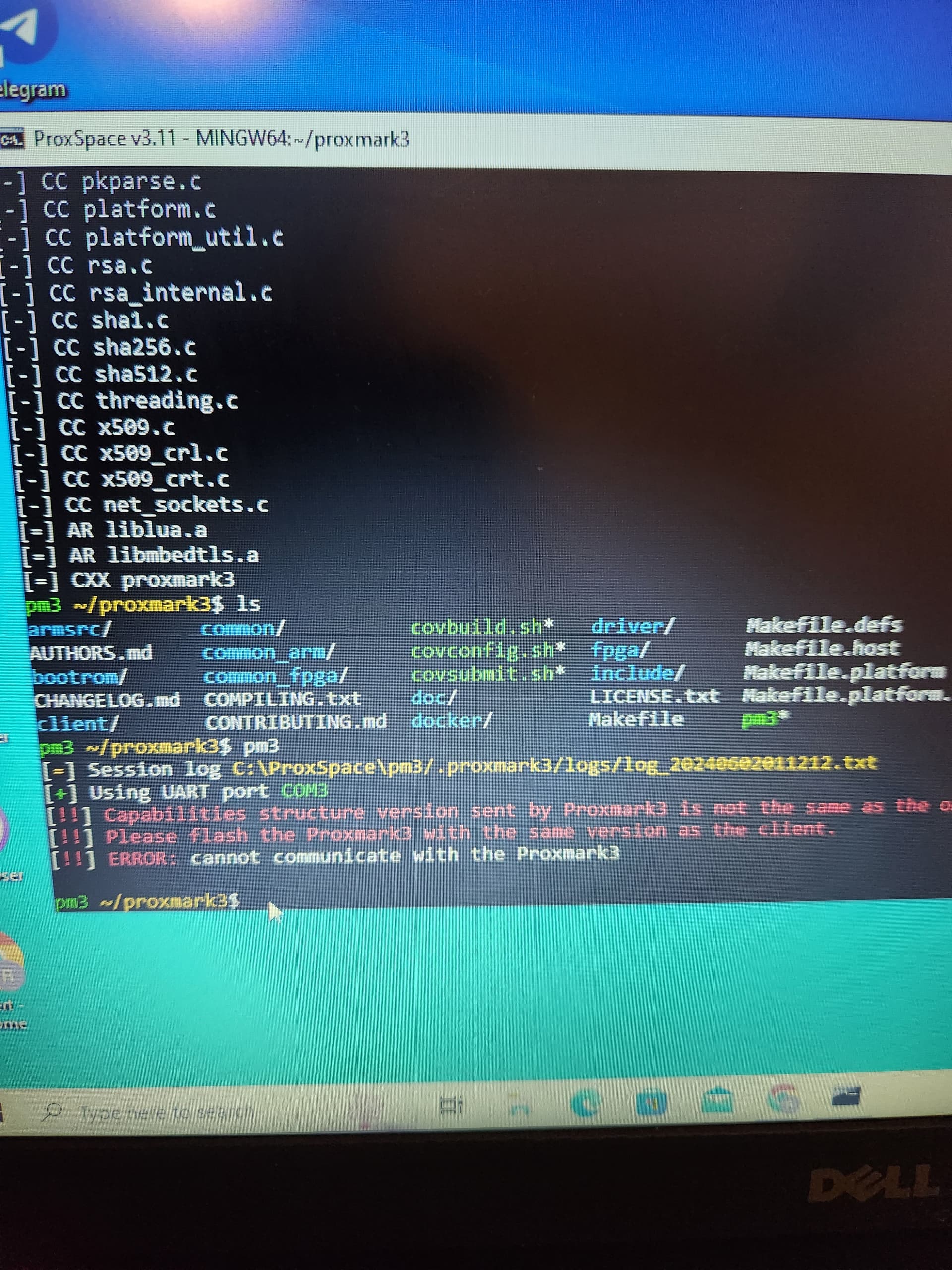

After make clean j8 all command it says this
Did you run ./pm3-flash-all?
Yes i did and i got it working…how do i get from pm3–>…to proxmark3 what is the command?
