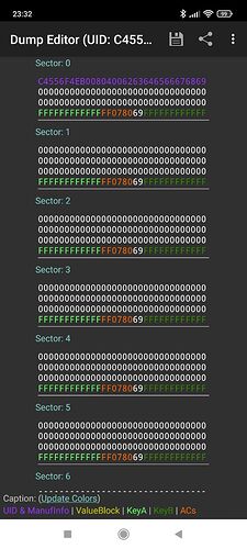

Not sure how to detect gen1a functionality.
Hmm so this is a strange thing with china and magic chips… CUID is meaningless as to whether it means gen1a or gen2… those terms aren’t even anything manufacturera are typically aware of… they are terms I believe were developed by the proxmark community actually.
So, this may be a gen2 card. You will have to use the standard block write commands to know for sure, or the MCT app for Android, to see if you can change the UID
Not sure how to perform this step correctly, I’d be grateful for a little bit more info or at least some kind of a reference.
Scanned the card via the app now, will post a screenshot of the result shortly.

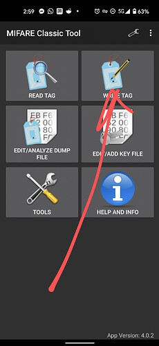

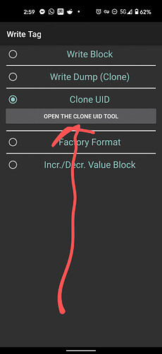

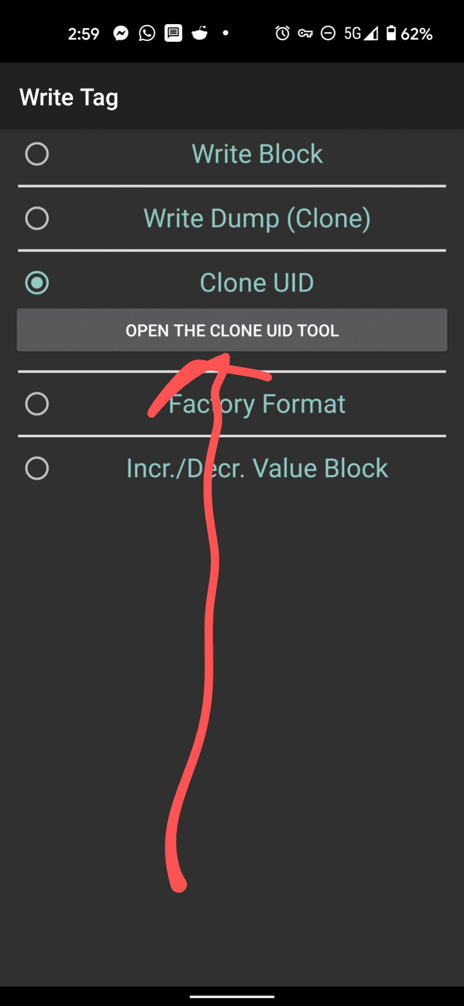

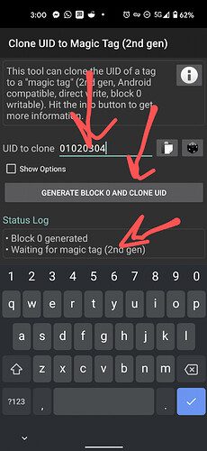

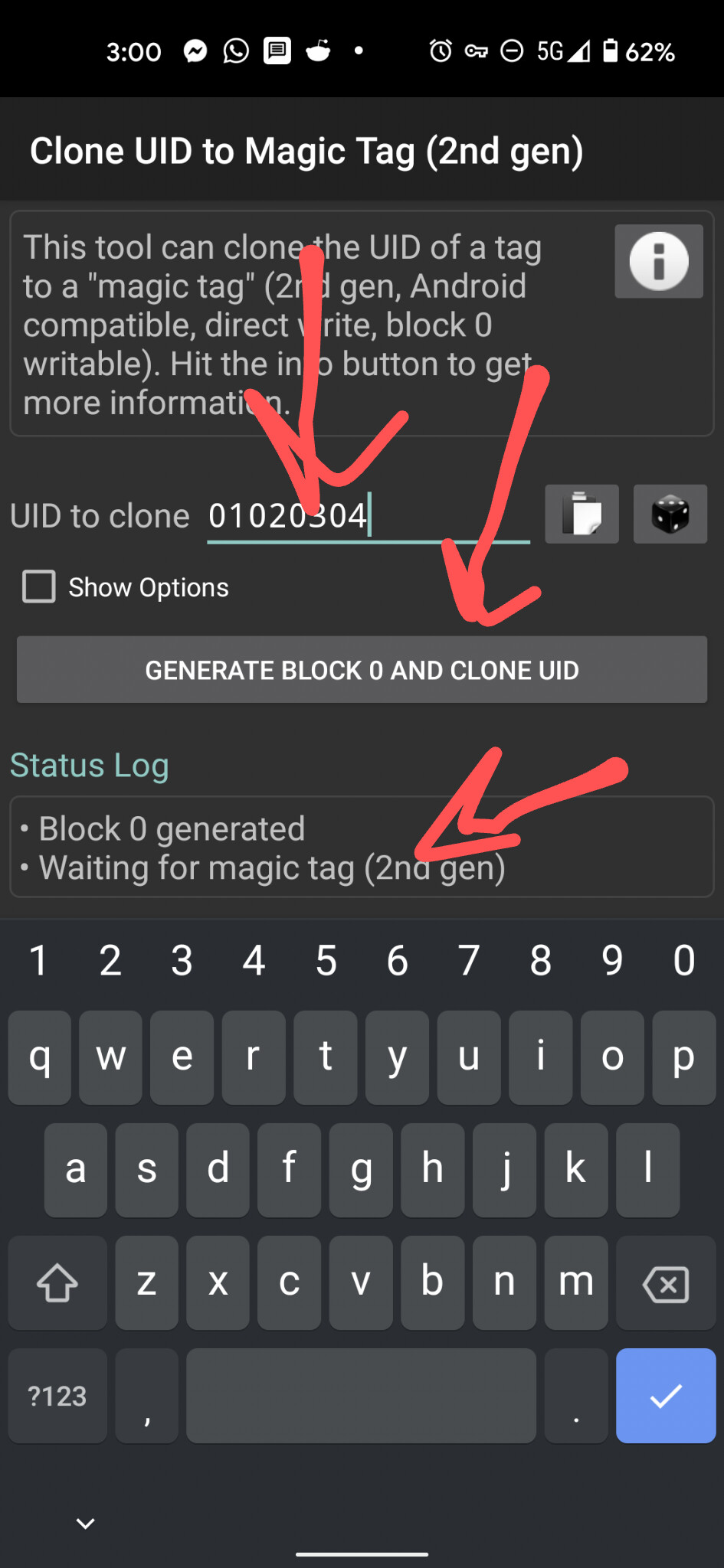

I already tried that while exploring the app, but I keep getting this
Even though the UID is in the correct format (HEX, no spaces, 7 bytes)

MCT can only write to a gen2a
So my guess is if you cant change the NUID a would be you have a gen1
Sure, I thought so as well, but if you choose to change the UID in ProxSpace hf mf menu, it offers you to change it to something from 4-7 bytes. Can’t send a screen right now though, I’m not home at the moment.
And the MCT Clone UID menu also offering the option to change from range of 4-10 bytes made me believe it is probably possible.
There are 7-byte UID-changeable cards, but they’re not nearly as common. This is why software would support it. It’s sadly not something that can be changed by software, it’s baked into the chip itself.

Since it has been confirmed that its not a gen1a, it’ll be useful to know what the keys are on sector 0 (where the UID is stored). On a blank card we can normally assume that the keys are default (FFFs) but to confirm this with a proxmark using the command hf mf chk --1k which should give you a table of found keys per sector.
Example Image Showing chk Output
Observed is that all sectors, keys A and B are using Fs which is the default.
