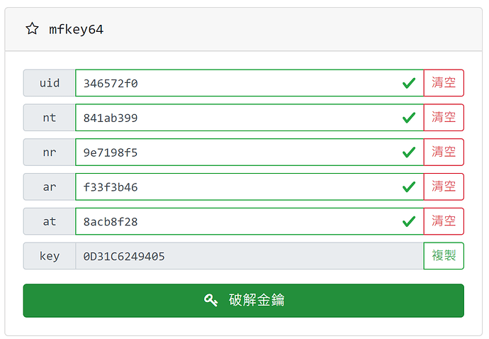

someone answered me by email, the thing is I don’t know who he is and he tells me the key (A) to 0D31C6249405. Fuck it works, how the fuck does that guy know that?

Because according to iceman and you at the moment there is no solution for a static encrypted nonce card. Reviewing all the information that I was discovering what was clear to me is that the only solution is to sniff the interaction of the card with the original reader of the machine and to be able to record that conversation so to speak (that will be the hard part for me). Or create a dictionary and get lucky with the keys after several days, this if I can say that it works half way, I got it because I intuited from other cards that usually start with a number and that’s what I did. If I had started with a letter, what I did would not work. Well I will wait for the super sniffer m1-4b to arrive and see how I do it in a little suspicious way. ![]()
I spent a hell of a long time looking at a lot of web pages and when I was almost given up I found this and it does work.
website: mfkey
Mfkey is what the pm3 does automatically with trace list -t mf (as far as I know)
this ^ (but easier)
