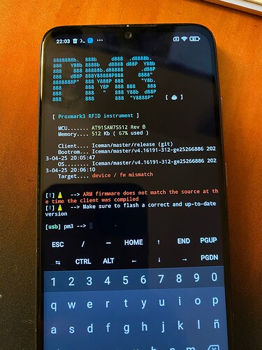

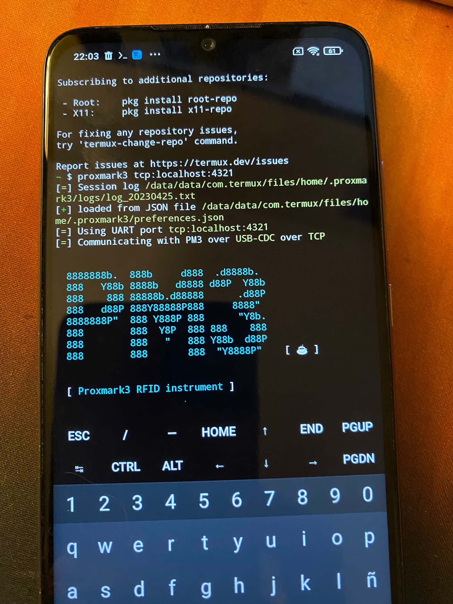

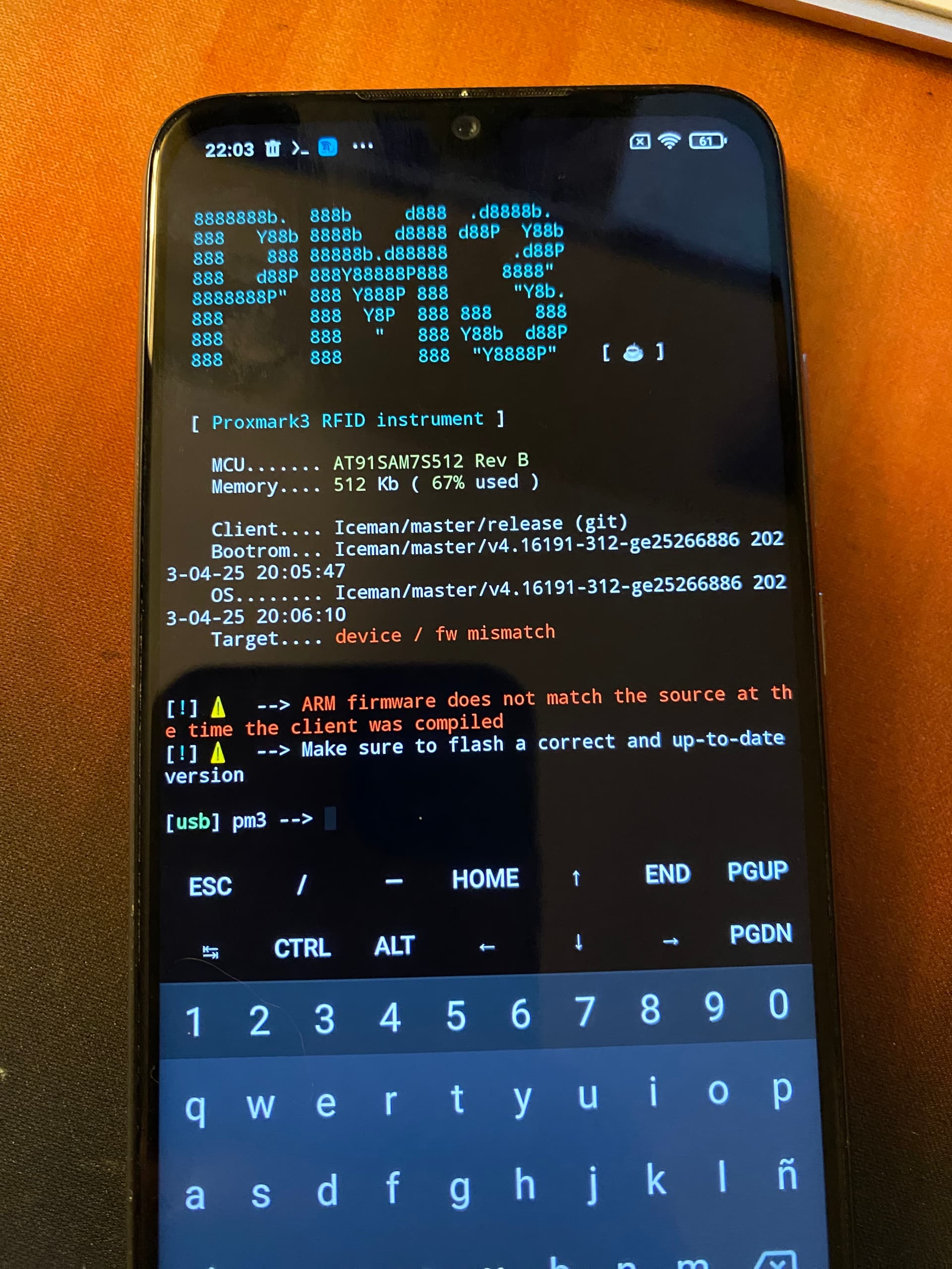

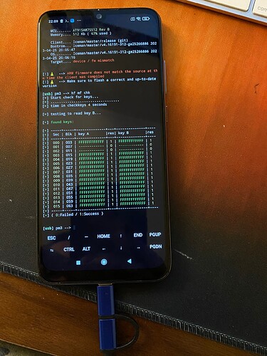

Well it seems that it went well, as I understand from what I searched the internet, what I have to do is to join the original card with the original reader, and make the supercard, this in turn will pick up the keys that have been said reader and original card. Reading it this way it seems easy, right. Well, let’s see what comes out of this, I’ll let you know.

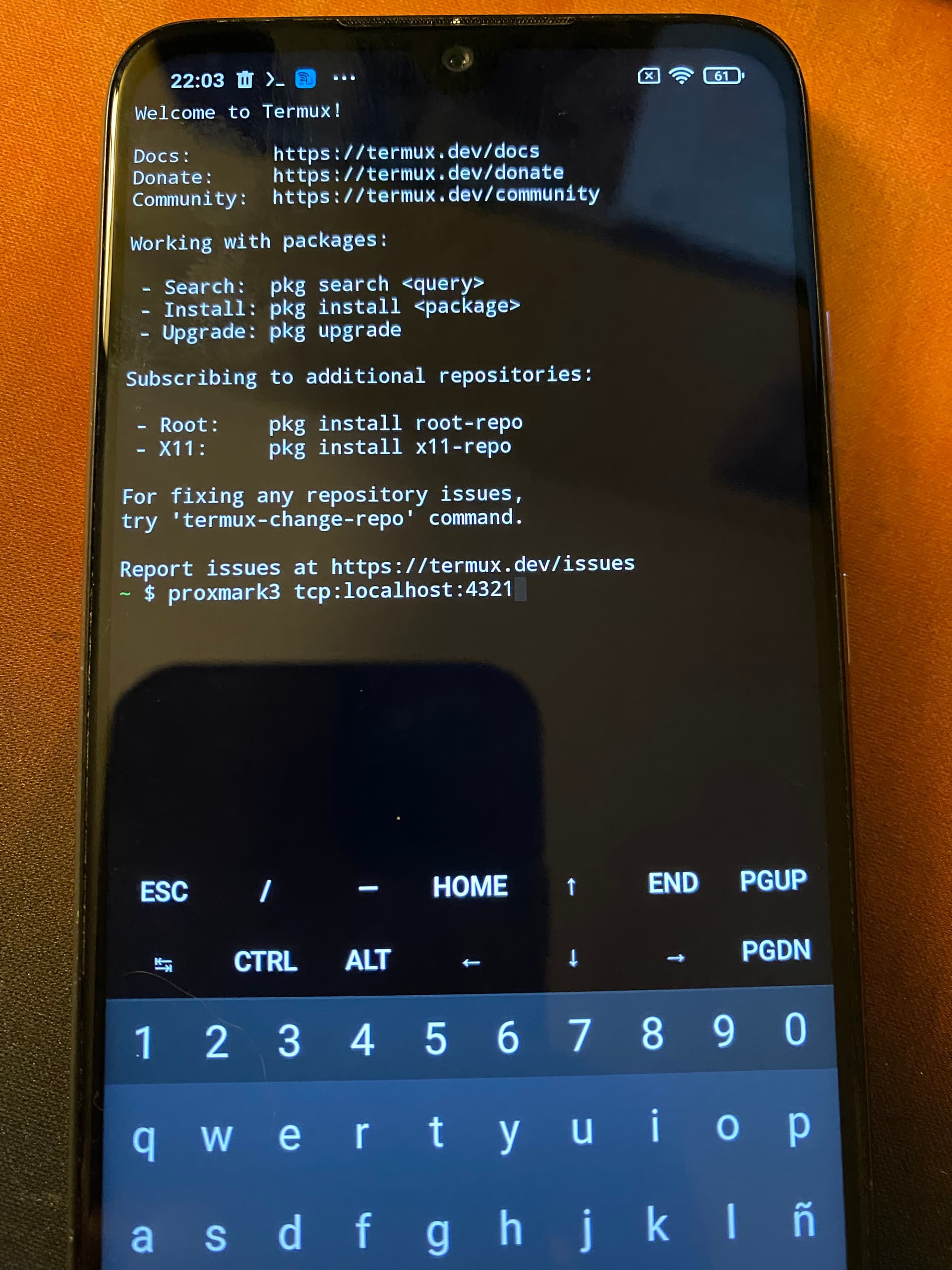

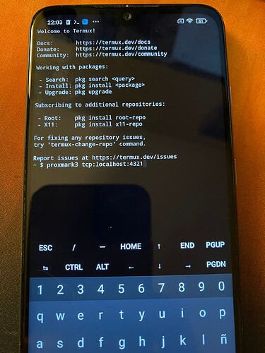

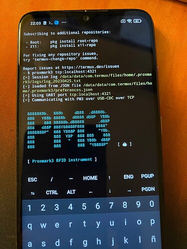

You can’t imagine what it took me to connect the proxmark3 to an android phone. But finally I can say that I have achieved it, not without suffering, but when you get it you do not see how good it feels.
For those who may be interested I leave the steps I have done, in order to use the proxmark3 with a mobile phone and thus be able to sniff the mifare classic 1k I have with its original reader, as it has a static encrypted nonce.
first: install TCP-UART
second: install termux, not the play store version.
Next: pkg install root-repo
pkg install x11-repo
apt upgrade
pkg install git
pkg install python
pkg install proxmark3-git
Once you have done all this, you have to connect your proxmark3 using a usb otg cable and you have to hit the TCP-UART application in connect, check server and put 4321 and hit start. Then open the termux application and type the following command: proxmark3 tcp:localhost:4321 and you are done.
One question guys? Yes I have this data, nt, nr, ar, but I don’t know at. Is there any way to know it manually or something? The data would be from block 8.
The data are from a sniff, sectors 1 and 2 are the ones that have the information, the remaining keys by default are fffffffff…
