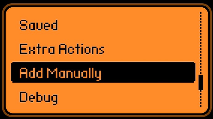

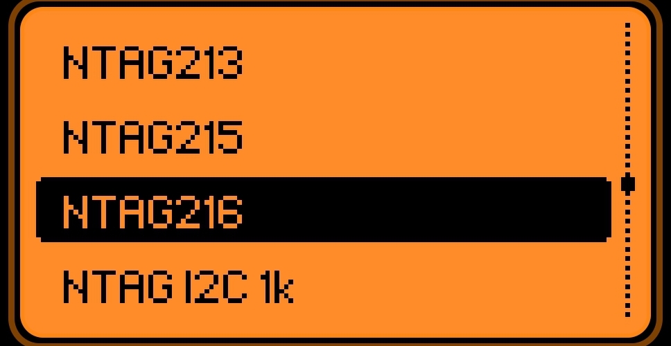

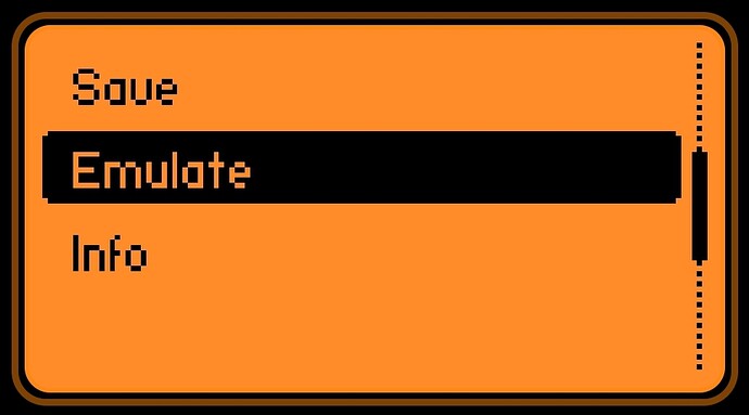

Do you know how to emulate a tag on the flipper?
Donyou know how to enroll a new tag to your lock?
Do you see where I am going with this?
Yes, the flipper shows the ISO14443-A from the tag.
I’ll try to write the tag to my xNT, maybe it works. I’m only a little bit concerned about blocking the chip with the flipper. I mean that the flipper create a write protect on it. But I don’t think that will be.
do you know how to enroll a new tag to the lock?
if so, Use your flipper to emulate a new NTAG216
While the Flipper is emulating, see if you can enroll that into your lock
